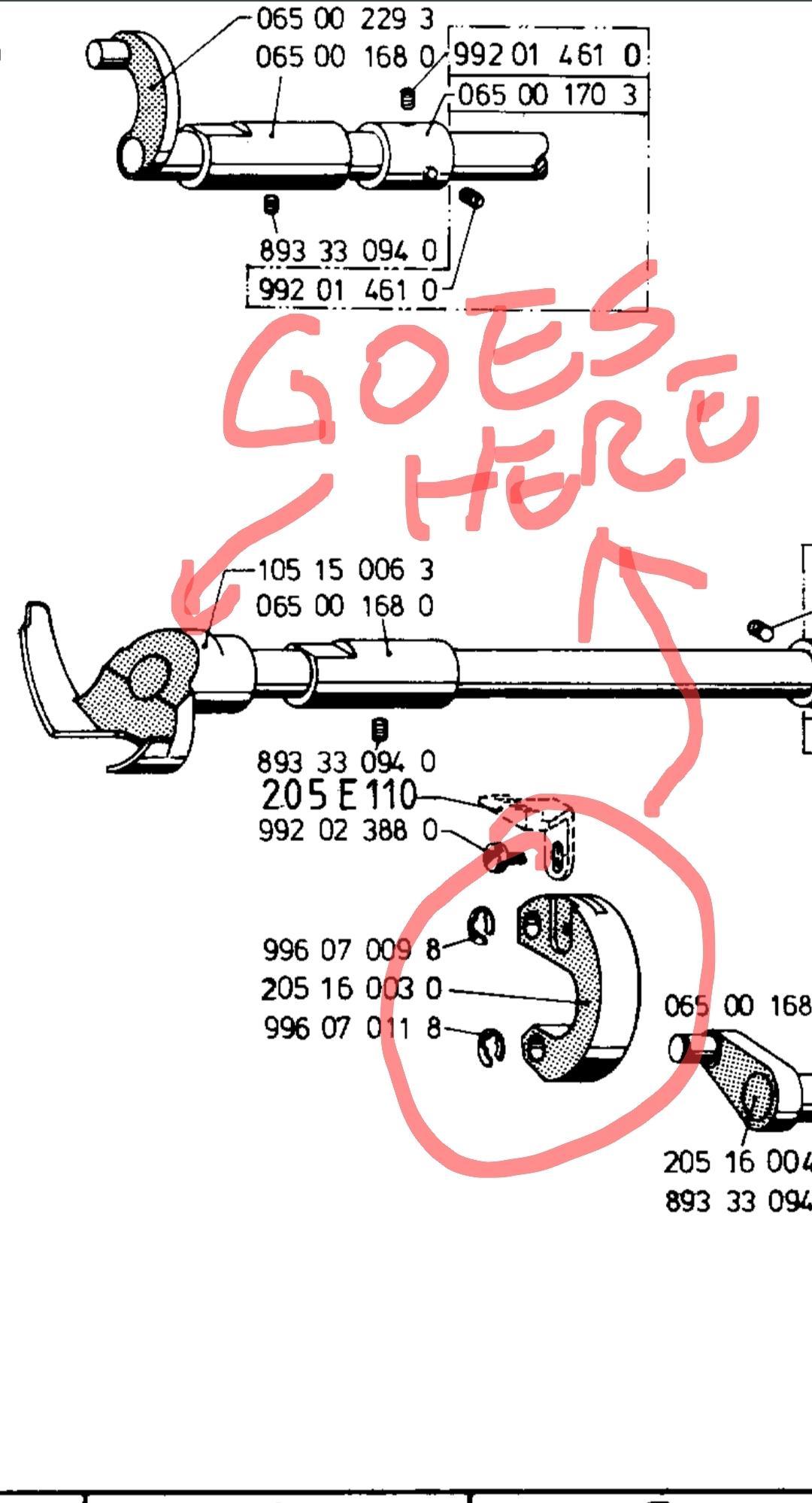

Can somebody with a Adler 205 64 or 370(could be similar) help me understand if the play that I have in my 64 subclass is ok or if it shouldn't be there?
I attached a photo, it is about the feed dog support which is actually a fork that raises and lowers the dog.
On mine, the play is somewhere at 0.2mm vertically.
Play no 2. I've identified an additional play in the take up lever and after some testing I have seen that the play is coming for the sliding bushing that goes in the cam. Now, in the parts list, that bushing is "angepasst" modified to various diameters to accomodate the wear...as far as I understand. How would you order the correct part? Test with some filler gauges?
