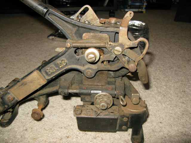

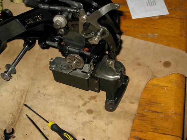

These are fantastic little machines, but infuriatingly difficult to find needles for any more. Pedersen made a clone, the Model #308 which is part-for-part compatible, but the last manufacturer of needles Groz Beckert in Germany no longer makes them and the only size they have in stock are the gigantic #8's.
Parts can still be had, if you've got enough money. I'm waiting on a quote to get some manufactured.
I've just finished restoring one from "been in a shed for 20 years" back to working condition, but I haven't yet got needles for it. If I can get a supply of needles then I'll go whole hog and get the plating restored as well and find replacement bobbin winder etc.
Here's my one:
As I got it:
After first strip and degrease/clean
After stripping the rust and properly cleaning it:
