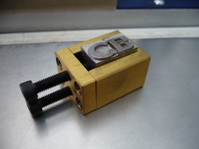

Members Red744T Posted April 1, 2009 Members Report Posted April 1, 2009 research has led to this interesting company:http://visimarkinc.com/datecoding/typeholders.shtm ed Hi Ed, I reposted the images from the other thread. I didn't make the holders. They came with the foil stamping machine we purchased. We don't do initials so we only use mounted copper dies in that machine. Those two letters in the holder also came with the machine. The holder in the image are part of a mechanical foil stamping machine that is held by cap screws, but for our pneumatic foil press, we hold the dies in place with thermal tape so in both cases, the dies travels with the moving press head. John Quote
