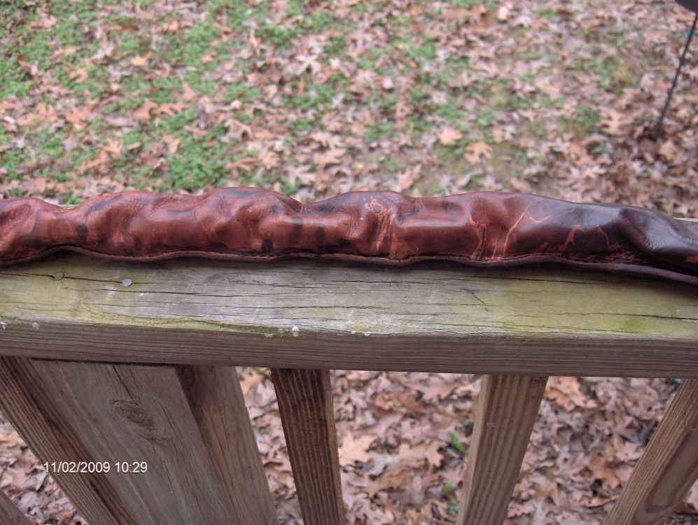

Funny this came up. Yesterday I had to wrap some chain for a guy who uses the chain as a handle on his gigantinormous pitbull. He needed to wrap the chain to be easier on his grip. The dog has that mottled coat, I think they call it "brindle"..not sure...my catahoula has the same coloring. Well, anyways, I tried to take advantage of some leather I had that really showed flaws when dying. I attempted to create the brindle look on purpose with it. Dunked the piece in a mixture of mahogany oil dye, and neatsfoot, and was rewarded with this result. I like it a lot, just hope I can duplicate again...
