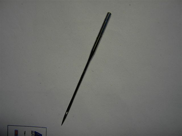

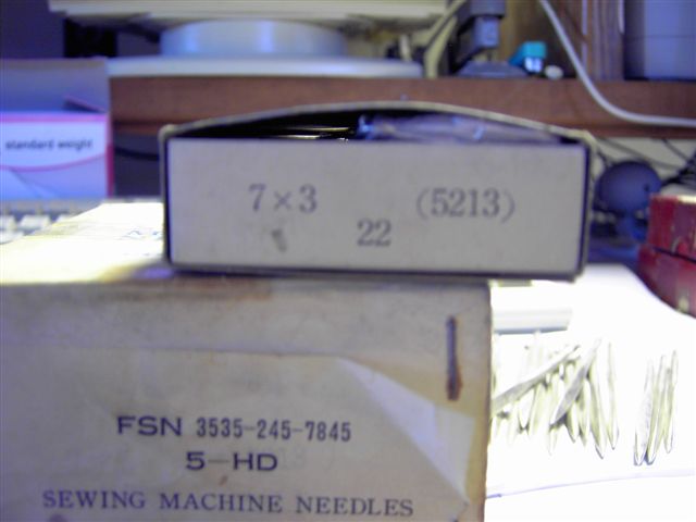

I have a large quntity of sewing machine needles, but I know nothing about sewing machines or how to size these needles.....any of you sewing machine gurus out there recognise any of this?
Hi Jeff,
The 7x3 are System 7x3 Size 22 (140) and are like system 794 but for Fabric/Webbing. They fit Adler 205-370 205-274, Juki 441 and clones, Singer 7 class, and the Boss. They are for about thread size 138.

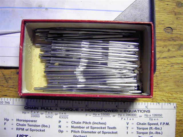

Perhaps. The question, though, is what sizes and point types do you have? Your pictures of the boxes show size 22 round points - not much use for that. It's hard to tell what the needles are that you show individually (like your first picture). So, quoting Brando - "Whatcha got"?
Bill
The box says round, but the points are sharp, could that be the shank they are refering to? Here are a few more pics
