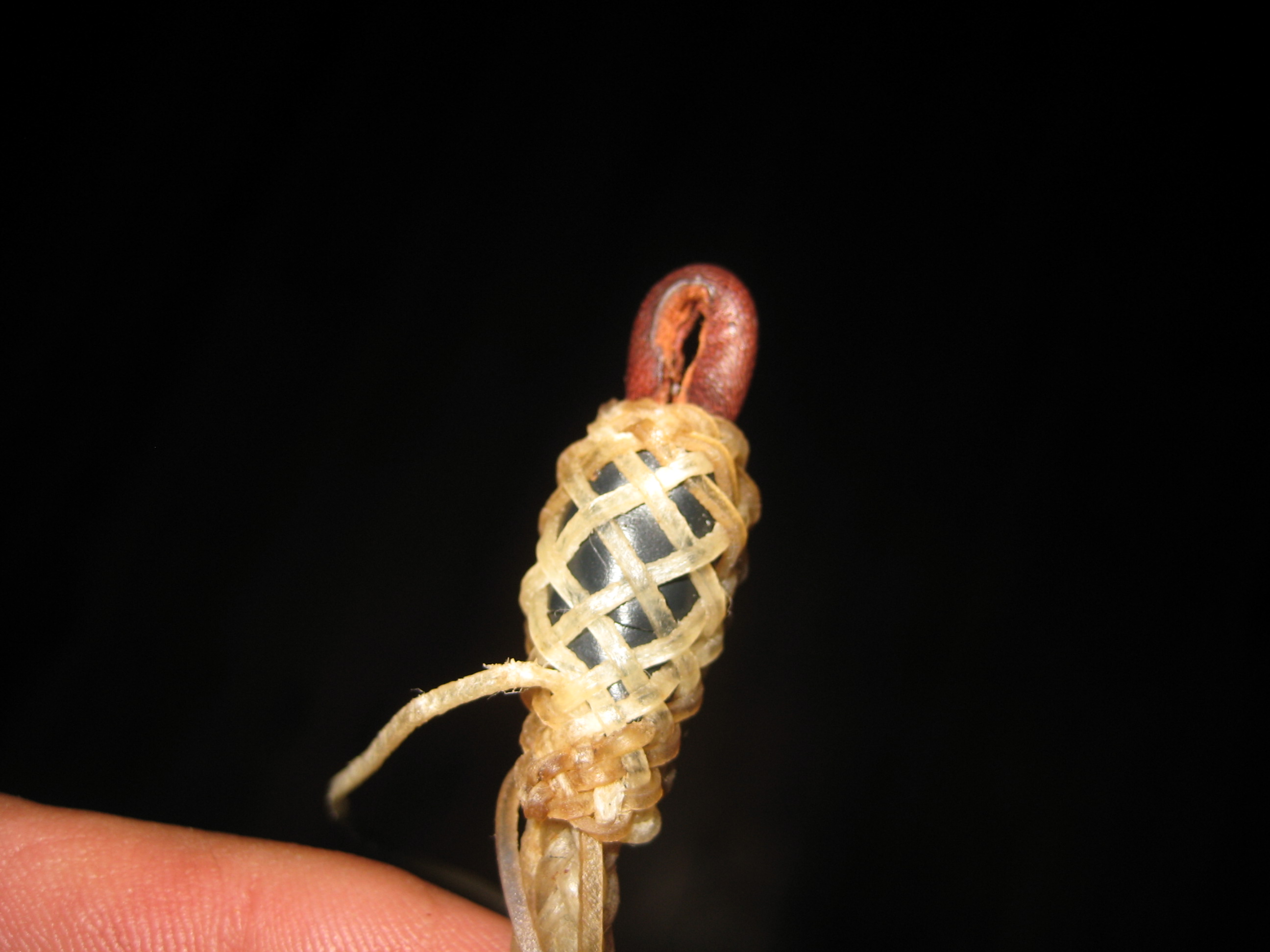

I was wondering if anybody else ever has trouble with the foundation getting crowded on one side when adding bights. It seems I've always had this happen but I just straighten it out before my interweaves. But on this knot it seems really bad I tried to move strings around as I added a bight. But after I made it a eight bight it really got crowded on one side. So is there any thing I can do different or does anyone have any tricks. Or I'm I stuck on trying to move this mess around and always having this problem. Any and all help appreciated.

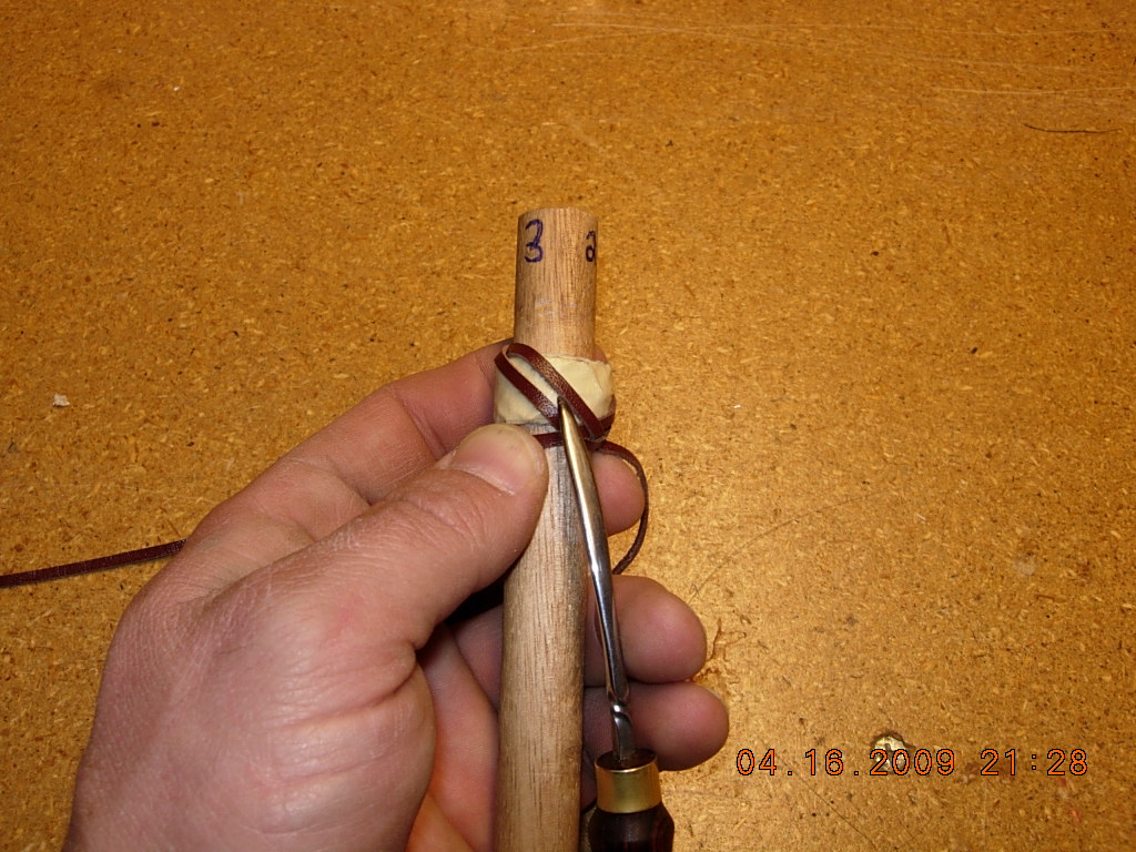

When I first start the button, it looks like this. DSCN2804.JPG The strands that cross in back are directly on the opposite side of where the strands cross in the front. The only difference is, in the back, they are at the top of the button. They cross at the bottom in the front. This will be important later on.
I pay really close attention to spaces between these, and all parallel strands. DSCN2807.JPG I point this space out with my fid. The spacing should be equal to or slightly less than the width of my strand. This is very important to maintain throughout the whole process. Every time I bring my strand around, I lay it in the same distance from the strand next to it.

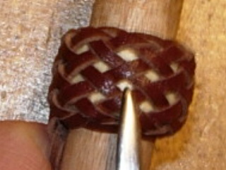

The button is finished here. In this picture, I am using my fid to point out the "boxes". RSCN2814.JPG While braiding the button, your parallel strands will begin to take up the "weave" look (O1, U1) and make these "boxes" or diamond shaped spaces. If you are keeping your parallel strands spaced the width of your strand, these boxes will be the same size or slightly smaller than your strand. When you come back through with your interweave, you will be in effect, filling in these boxes. If they are wider than the strand you are braiding with, you will have gaps in the strands of your "finished" (meaning after you run your interweave) button. If your boxes are evenly distributed around your button and are still larger than your strand, you have 2 choices. You can make another set of passes and increase the size of your foundation button, or when you do your interweave, you can make more passes. I highly recommend you make an additional pass in your foundation if you are just getting started.
When I am dressing up a button before an interweave, I make sure that the crosses that my strands make are in line with the other crosses both vertically and horizontally. They should match up with the crosses your bights make also. After that, you do what ever interweave you have chosen to do and finish the button.
