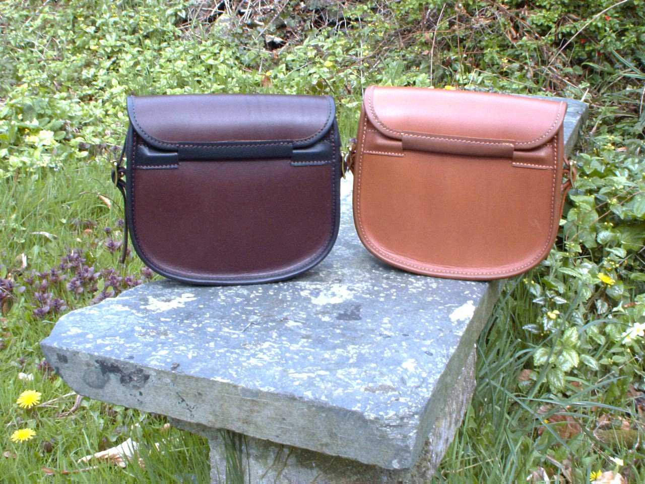

Members SteveBrambley Posted April 17, 2009 Members Report Posted April 17, 2009 Hi, Here's a couple of small cartridge Bags that I just finished today. They are made from my usual veg tanned, 3-3.5mm (8-9oz) 'saddle shoulder' (cow hide) and are lined in brown pig-skin suede. The piping (welting?) is 1mm cow-hide with a 2mm PVC core. Steve Quote
Members badger Posted April 17, 2009 Members Report Posted April 17, 2009 Lovely work Steve, Traditional yet contemporary at the same time. Cheers, Badger Quote
Members celticleather Posted April 17, 2009 Members Report Posted April 17, 2009 The usual Brambley excellence! I like the hinge system on the flap . . . very neat. Terry Quote
Members SteveBrambley Posted April 17, 2009 Author Members Report Posted April 17, 2009 Thanks guys, I really appreciate your comments! Steve Quote
