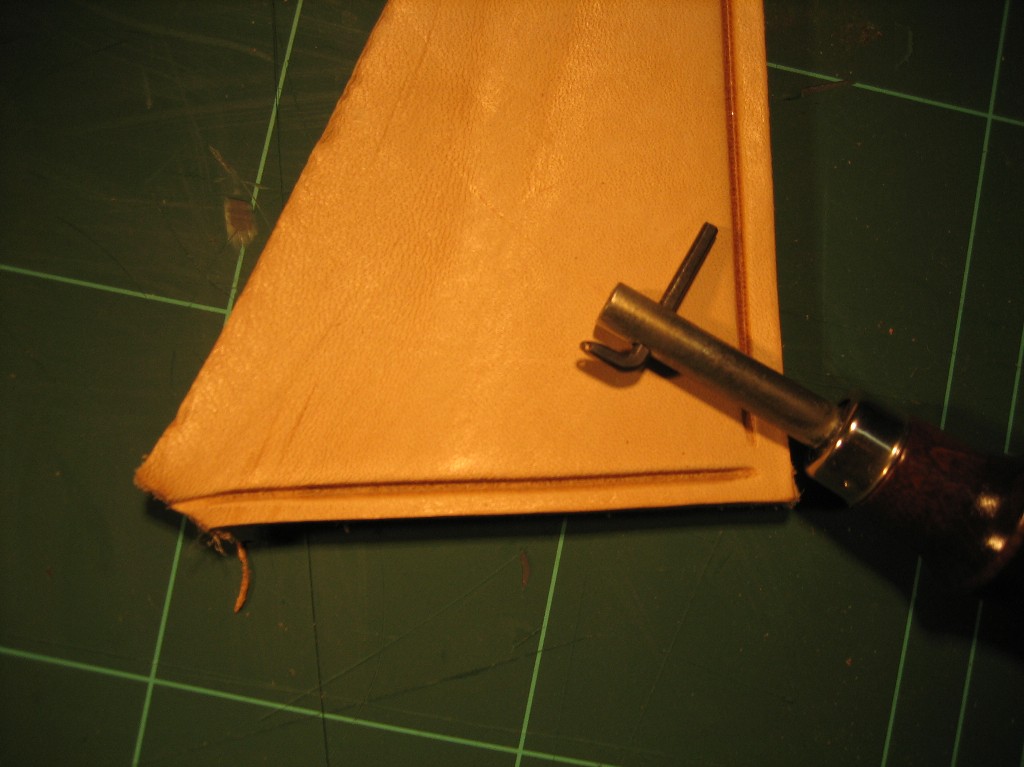

1.. before assambly and dying do a border edge,

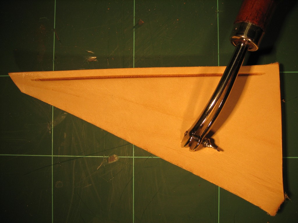

2.. the same for the stitching with a stitching grover,

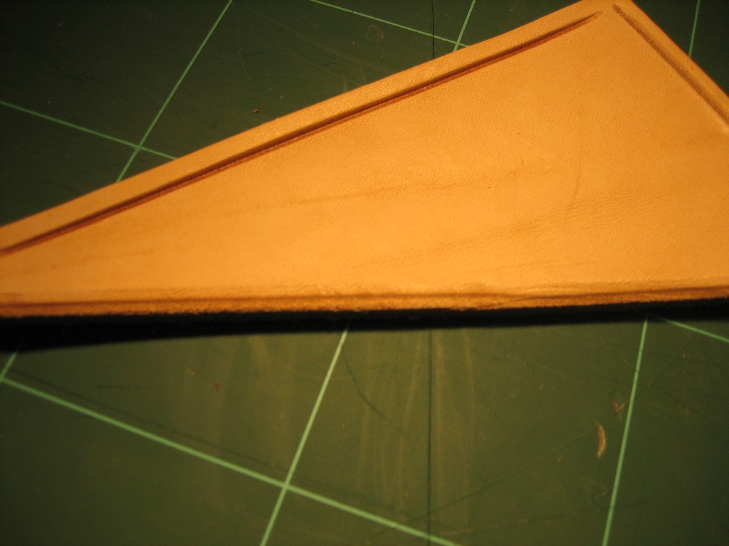

3.. here is an example of the tandy edger it is flat and no matter how hard you try to polish you wont get a realy nice round edge,
4.. here you can see how flat it is,

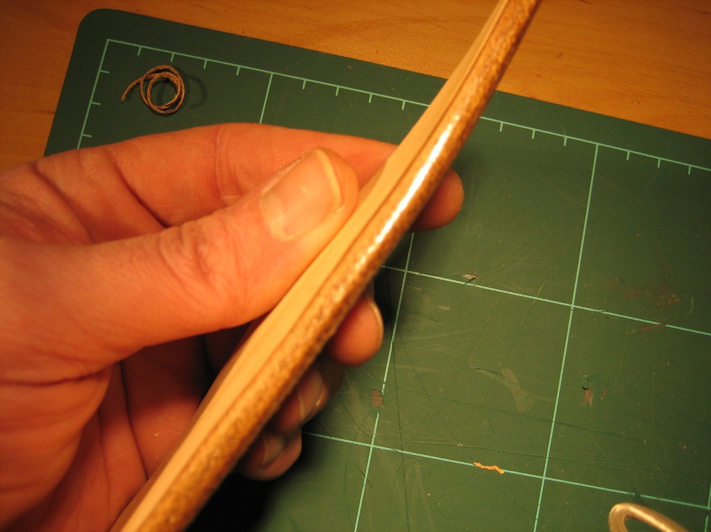

11.. here you can see i rubed for about one minute with the hand held slicker, it should shine like glass,
12.. the same with the back side,

On the stitching, it helps to use a stitching groover to sink the stiches below the leather surface. That not only keeps the thread from wearing, but it also helps to keep your stitches looking more even.
