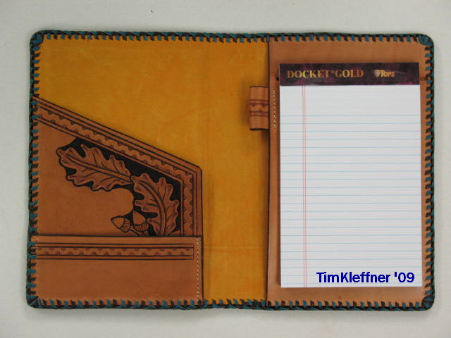

Howdy Cord
After I tool a piece , I dye my back ground with either Fiebings mahogany dark brown or chocolate spirit dye. After that, I lacquer the project, after 8-10 hrs cure time, I antique with med brown or Sheridan brown or mahogany Fiebings antique. work fast, wipe most of it off, then apply Tan Kote. ...
Dying the back ground.. good brushes .. practice practice practice. Really it's not rocket science, but it does take practice to keep from smudging onto a leaf or flower.
Happy tooling
Tim
