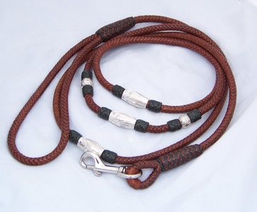

Members entiendo Posted November 19, 2009 Author Members Report Posted November 19, 2009 (edited) Oh WOW..that is lovely and smoooooth. I had no idea. And it looks just as lovely as roo! Oh what a nice patina. I love hearing about how others do things.I'll post a picture when I'm done with the lead. In the meantime I'll post one of my other pieces. New picture, that first file was way to large. Edited November 19, 2009 by entiendo Quote
Members 8thsinner Posted November 20, 2009 Members Report Posted November 20, 2009 Now I bet that took a few hours. It looks great. And the pattern is a good one. Is that roo? Now you know one of the things I noticed when drying some more of my red stuff last night, Mainly I stretch dry over a bottle or something, and given that the flesh side is always weaker, it compresses more, that compression, when dried leaves a few hairs out the sides of itself. SO, after it's dried like that and I run it through the splitter all the wider bits will be chopped off essentially sort of skiving it naturally. When it's braided tightly nothing flesh side will be left to spill out. Thats at least the way I figure it. Do you mind if I critique that piece of yours? Quote Doing the right thing is bleeding for the cause. Website Facebook
Members entiendo Posted November 20, 2009 Author Members Report Posted November 20, 2009 Of course..critique away, anyone, I'm always up for suggestion on how I might make a nicer piece. Yes, it's roo. Roo is all I braid with. It's strong, beautiful and very easy to work with. I don't know how to do a lot of the prep work you described. I'd like to try rawhide but so far I haven't. I really admire the rawhide pieces, even more than that I admire those who start out braiding with rawhide. I tried goat once but didn't like it at all. It kept stretching and stretching and it was very hard on my blades. Sometimes I'll have a hide where the rough out side is a little rough, I usually bevel it off if it is real bad or leave it if it's not. But for the most part I cut, stretch, cut again, bevel and braid. Quote
Members 8thsinner Posted November 20, 2009 Members Report Posted November 20, 2009 (edited) The long pineapple by the looks of it when your pulling through seems to be stretching the roo. I say that because it seems ovular by comparison to the parallels of the lace, if you know what i mean. Close to the under pass it's not as wide... If it is stretching I suggest stretching it through your hands or soaking and stretching over a bottle overnight or tie a tight turkshead, about 5 or 7 parts over a dowel then work the lace back and forth through under the whole thing or just increase the sequence of the pineapple, it might help to straigten out the appearance. How do you actually stretch yours normally? The sofa stuff is lovely but Theres a lot of prep to Get there. Cut to 5mm, stretched over night, shrinks to about 2mm, split to about .8 or so, then stretched again, worked well through the hands with saddle soap homemade then finally put to use. But it's very strong at those sizes. Never worked goat before, pig at 1.5mm glazed is very nice easy to lace from small circles, often doesn't need worked on the back and doesn't need a lot of stretching... And it's cheap. As for roo, I know how nice it is to work with. Love the stuff, I have done one whip with it but its a bitch to get in the UK. I need to Get some sort of import licence i think...can't Get reliable info. By the look of your work. And mine, i think we could do awesome work instead of very good work with a few more opportunities and tools. And or money and time... Edited November 20, 2009 by 8thsinner Quote Doing the right thing is bleeding for the cause. Website Facebook
Members 8thsinner Posted November 20, 2009 Members Report Posted November 20, 2009 The long pineapple by the looks of it when your pulling through seems to be stretching the roo. I say that because it seems ovular by comparison to the parallels of them. If it is stetching, I suggest stretching it through your hands or soaking and stretching over a bottle overnight or tie a tight turkshead, about 5 or 7 parts over a dowel then work the lace back and forth throuh under the whole thing or just increase the sequence of the pineapple, it might help to straigten out the lines. How do you actually stretch yours? As for roo, I know how nice it is to work with. Love the stuff, I have done one whip with it but its a bitch to get in the UK. Quote Doing the right thing is bleeding for the cause. Website Facebook
