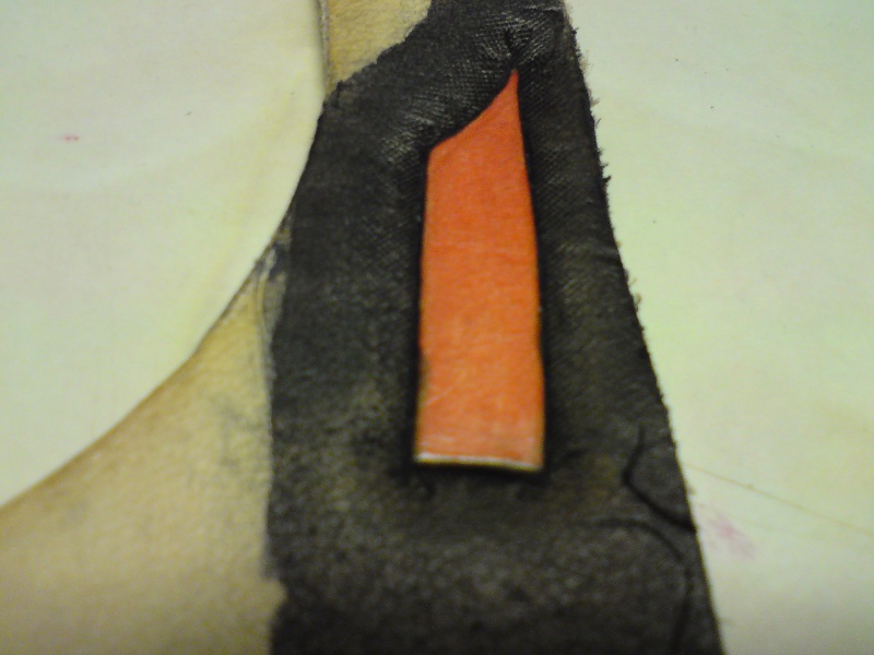

Members OdinUK Posted November 20, 2009 Members Report Posted November 20, 2009 I tried my first painting and dying exercise. I first cut and bevelled a shape, I painted the raised part in 3 applications of red acrylic that was thinned with a little water, then I dyed the surrounding area twice before buffing the dyed area to remove the excess black. I did this as two samples. Then I used the Baslm and Atom wax on one sample, left it to dry and then buffed it, but a lot of the red paint just came off with the buffing. I have attached a picture of this and a picture of how the other sample looked without the Baslm and Atom Wax. Please can anyone advise how to stop this happening? Ideally Id like a water resistant sheen to the painted and dyed item. If possible I would like a good red (bright if thats the right word to describe it) colour on the raised area with the rest dyed black. Thank you. Quote Lord Of Leather

Members whinewine Posted November 20, 2009 Members Report Posted November 20, 2009 I tried my first painting and dying exercise. I first cut and bevelled a shape, I painted the raised part in 3 applications of red acrylic that was thinned with a little water, then I dyed the surrounding area twice before buffing the dyed area to remove the excess black. I did this as two samples. Then I used the Baslm and Atom wax on one sample, left it to dry and then buffed it, but a lot of the red paint just came off with the buffing. I have attached a picture of this and a picture of how the other sample looked without the Baslm and Atom Wax. Please can anyone advise how to stop this happening? Ideally Id like a water resistant sheen to the painted and dyed item. If possible I would like a good red (bright if thats the right word to describe it) colour on the raised area with the rest dyed black. Thank you. Odin: simple question... why would you not use a resist such as latex first, dye black, blot the latex to remove the remaining liquid black, then remove the latex when dry, buff the black, then paint with red? The black is a dye- it seeps into the leather. The red is a paint- it primarily stays ON THE SURFACE- if you buff it vigorously, paint will rub off. If you don't want to go to the trouble of using latex, then carefully dye around, then buff the black areas, carefully staying away from the un-dyed area. After buffing, THEN paint. There are certainly other ways to approach this, but I've used both these methods. Personally I've never been a fan of the atom wax stuff- I don't think it is particularly water resistant- I much prefer Neatlac of Saddlelac (both sprays, so the colors/dyes can't run), or, if I must use a water-based finish, Fiebings Leather Sheen spray. Additionally, if you will spray on a finish (light coats, so the dyes/paints can't run into one another) you often don't really need to buff the dyed areas, especially if the dyed areas are small and/or are not going to be constantly rubbing against clothing (like a belt or a wallet). Quote

Members whinewine Posted November 20, 2009 Members Report Posted November 20, 2009 Thanks for the advice. Are the Neatlac and Saddlelac water resistant and would they offer some protection from rubbing? It doesnt have to be waterbased, as long as it 'seals' the paint from the elements. Can ordinary laquer spray paint be used on leather? I'll look into these products over the weekend. Odin: the neatlac & saddlelac are both lacquer based, they provide a much greater water resistance than do the water based finishes, and they do seal things quite nicely from the elements. And yes, they will provide protection from rubbing. But paint, being paint, whether brushed on or sprayed on, will still sit primarily on the surfaces, & thus, will rub off if abraded. I don't know if these products [neatlac/saddlelac] can be gotten where you live, although krylon, as Wildrose suggested, is probably available. While not a lacquer base, , it is a plastic or poly base (or so I have been told, so don't quote me on that). I have also used krylon clear spray, and it does dry very quickly. Good luck! (Btw, what ARE you making that has such a rubbing concern?-To paraphrase Shakespeare, "Ah, what is the rub?") russ Quote
