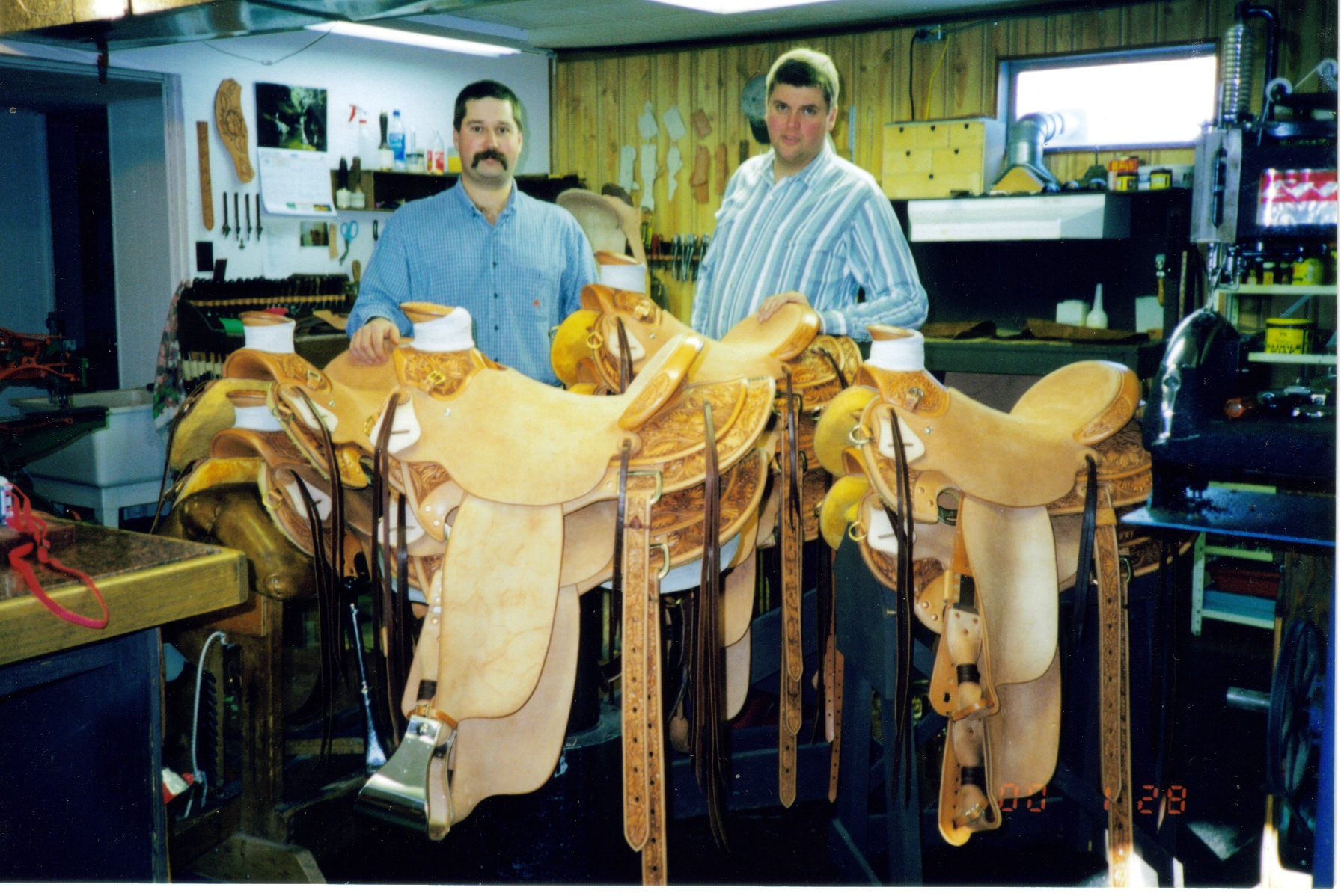

Myself and John Visser made the hunt saddles for a couple of years, we made two different saddles. the " ray hunt" saddles were made on a wade (5" stock) with a flat plate riggin, the "Carolyn hunt" saddles were made on a "Ray Hunt tree" (4 1/2" stock) with an inskirt riggin. On all the Hunt saddles the maker stamp read " Trails end saddle shop, makers, on all saddles that Dale makes himself the maker stamp reads maker not makers
On the Hunt saddles that John and I made we put a serial # on the skirt under the right seat jockey, all the saddle John made the # starts with JV and all of mine start with SM.
Steve
here is a photo of John and I with a stack of Hunt Saddles.

Wow, that's a stack of saddles, all right, Steve! You and John were very, very busy. :)
Steve
Shakin my head and grinning. Thinking How cool is that!
