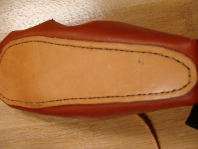

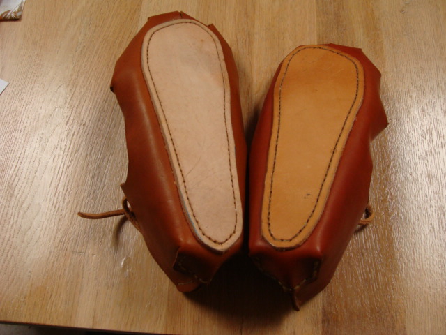

Members gunter Posted January 1, 2010 Author Members Report Posted January 1, 2010 Jim, Thank you! I have made other styles of moccasins for personal use and for others and that is a great pattern! I love the buckle feature. My next question is are you going to stiffen the sole of the shoe on the outside or inside and what type of material are you using ? I mean, are you using a suede, or is it veg-tan and what ounce/size have you made this with? I can see these being made with a nice 7-8 oz and used as daily wear. ALL of the moccasins I have made to date are worn as "house slippers" and I don't know how to make a solid or hard sole! Thank you for your patience! Di Hi, All the moccasins I've made in the past, were for use in the field as a re-enactor, so for the durability and strenght of the moccasinsole I've putt a double 2mm thick leather ( 2 pieces of 2mm thick on each other) sewn on the sole of the moccasin. ANd I must say, it works, they keep on going for about 7 years now, without reparing them. Just a tip, if you can't putt a hard leather sole beneat the moc, use cowhide with the hair on the outside, smooth walk, durable last. Cheers, Gunter P.S. The pic included isn't from a moc, but from a Irish Brogue I made for firend of mine, with the same soletype ;-). Quote Once I moved about like the wind, but now I surrender.(Geronimo) Failure is always an option
