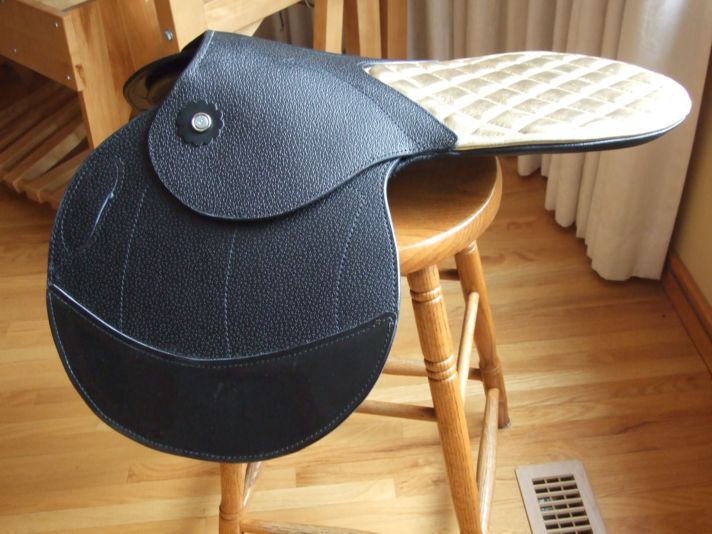

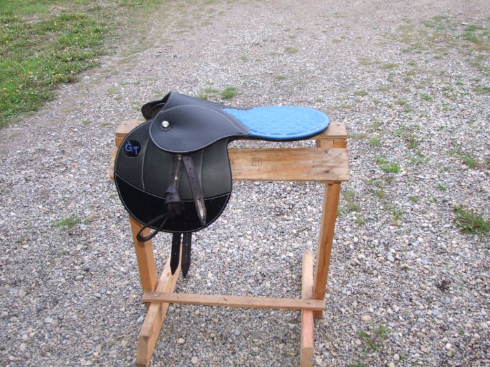

Decided to try and post pics of a couple of exercise saddles I have made. The gold one is lacking billets and initials, but other than that, is pretty much done. Speaking of initials, I have been using a local firm that does nylon embroidery on a patent leather backing. It has worked well, but occasionally someone wants lettering in leather. I would appreciate it if anyone could help me with a source. I know I cant make them.

You need a new handle!!!! Perhaps Master Racing Saddler!!!That is one elegant piece of work. Excellent craftsmanship!!! :You_Rock_Emoticon:

AAAAAAHHHHHHH a fellow Canadian. I know nothing about saddles but from what I can see those look pretty sweet.

Great looking saddles. Are they for a Northlands client? It was -48C here in the Queen City so I feel your pain.

Thanks Denise for the idea, and those others that took time to look or make comments. One of the nice things about leatherwork, or I suspect any other hobby is you never quite get things right, and that keeps you coming back for more.
Still, its nice when people praise your efforts.
Here is a picture of a exercise saddle tree. Most of them are made out of aluminum, although fiberglass, and sometimes wood, reinforced with metal
are also used. Most of the metal ones are stamped Mexico, although I get mine cast locally. The metal piece attached to the side are called stirrup bars, and are supposed to release if a rider comes off, and is being drug. It is far from a perfect mechanism, and can be good or useless, depending on the saddle. I do a lot of repairs for the local racetrack, and on average get at least 50 a year where something has gone wrong with the tree. Occasionally, the tree itself breaks, but the most common problem is failure of the rivets that hold the stirrup bar in place. Not a pleasant feeling if you are a rider!
