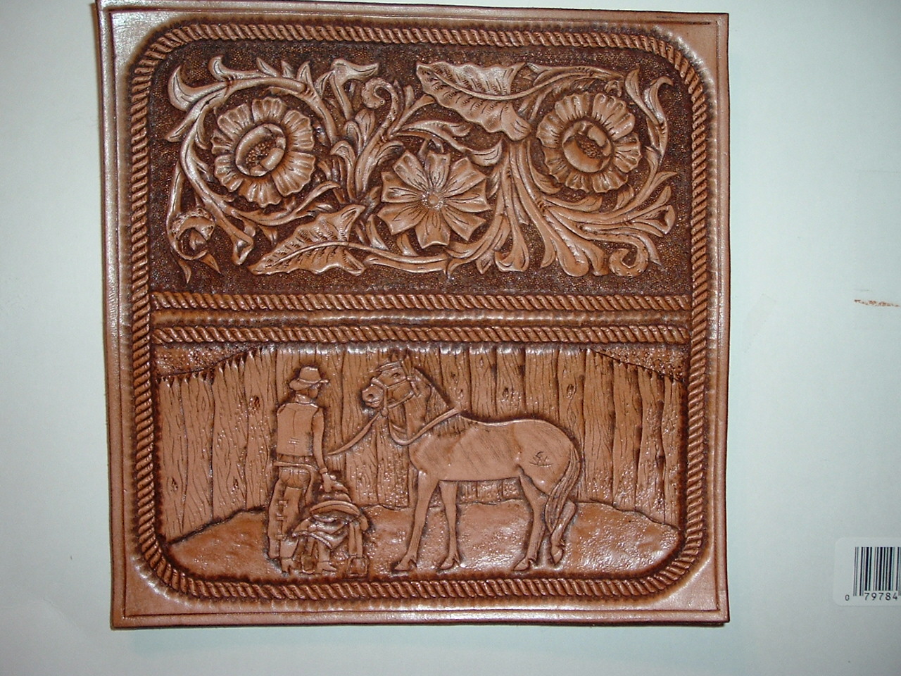

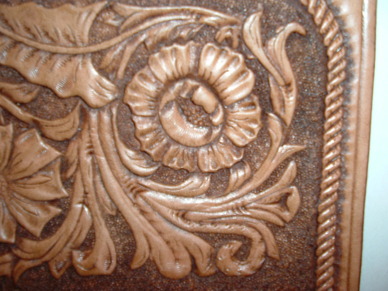

Members Chuck Posted January 11, 2008 Members Report Posted January 11, 2008 About six months ago I decided I wanted to build miniature saddles, twenty years ago I built regular but plain saddles. They were stout and rode very well, built mostly for family and friends. They lacked the look that I wanted. Now retired I want to learn to tool and I like the sheridan style carving so that is my goal. Please critique the practice Checkbook cover. Thanks Chuck Quote
Ambassador Beaverslayer Posted January 12, 2008 Ambassador Report Posted January 12, 2008 Very Very nice Chuck, I love the rope border. Ken Quote
Members Chuck Posted January 13, 2008 Author Members Report Posted January 13, 2008 Very Very nice Chuck, I love the rope border.Ken Thanks Ken, I used a 959 TLF rope stamp and bordered it with a Barry King #1 concave checkered beveler. Works great. Chuck Quote
Members Hidemechanic Posted January 13, 2008 Members Report Posted January 13, 2008 Chuck, you gotta stop calling this practice. It's on going work,the real stuff. If I can suggest something, as a matter of personal preference only, do a 'real' practice piece like on some srcap( not everything we do has to be usable, it's part of the education process). Do a couple leafs as you have in this patern. Suggestion one, try leaving out the decorative cuts and leave just the veiners and compare it to the one with dec cuts. I think it helps things to not be quite so busy. Second suggestion, do the same (practice piece with leaf) using a shader with vertical(or cross hatch or smooth) lines rather than horizontal. The reason(personal preference again) is, it seems like my eye feels a conflict with the flow of things in the leaf. Though the horiz. lines on your shader are going the same direction as the main vein of the leaf, it also seems that the direction of the taper left from the shader is going toward the main vein. Technically I said that backwards, a real leaf in nature the main vein is carrying nutrients to the leaf parts starting from the stem, then radiating out through the smaller veins as they turn outward yet moving toward the tip of the leaf. We are always attempting to fine tune our designs so as to be pleasing to the eye, this is one of the ways I try to learn the 'language of design'(looking for flow). I do like your design, makes me want to go make a wallet. I resently made a kidney belt with similar blossoms. I like the old south of the border style. Keep up the "practice" you're doing great work. GHackett P.S., I meant to say that I think your horiz. shader works for the blossoms. Quote
Members Chuck Posted January 13, 2008 Author Members Report Posted January 13, 2008 This is practice for me, my Goal is to build the finest miniature half scale saddles I can. A lot of what I am showing now is Sheridan style patterns that I have designed and drawn myself. I want to get the tooling correct first. I am also working out patterns for the various miniature trees that I have, both tooling and leather pieces. That said, I will I will try to clean up the knife cuts. I think I tend to follow the theory that if a little is good a lot is better, both with the knife cuts and the veiners. In the book Sheridan Style Carving by Bob Likewise he states that the vertical lined thumbprint is generally used in Sheridan tooling. However, when I look at the pictures in the book they seem to use the smooth, so I have tried both. I tend to agree with you, on the leaves it doesn't flow properly. I am working on the tooling pattern for the seat jockey and will post the pattern and the practice piece. I will try to use the sugestions that I have received from the people on the Leather Worker net. Thanks for all your comments. Chuck Quote
Ambassador pete Posted January 13, 2008 Ambassador Report Posted January 13, 2008 About six months ago I decided I wanted to build miniature saddles, twenty years ago I built regular but plain saddles. They were stout and rode very well, built mostly for family and friends. They lacked the look that I wanted. Now retired I want to learn to tool and I like the sheridan style carving so that is my goal. Please critique the practice Checkbook cover. Thanks Chuck Chuck- nice work. You have a feel for drawing that I struggle with- I'm envious! As far as the shaders... I would get a pear shader with very fine horizontal lines. I got one from Hidecrafter in their catalog under the SHERIDAN tools. Not expensive by Barry King et al prices but well worth it. Hint!- do all of your pear shading on the leaf tips deeply and draw(walk) the shader down towards the center. THEN go back and make 1 wack with the lined shader at the tip. again- nice work! ps- draw a pattern for me- I'de love to try it and post it. pete Quote

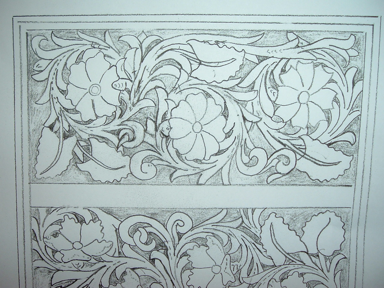

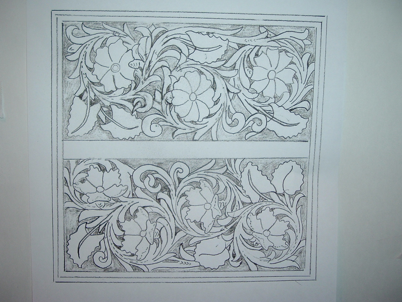

Members Chuck Posted January 13, 2008 Author Members Report Posted January 13, 2008 Chuck- nice work. You have a feel for drawing that I struggle with- I'm envious!As far as the shaders... I would get a pear shader with very fine horizontal lines. I got one from Hidecrafter in their catalog under the SHERIDAN tools. Not expensive by Barry King et al prices but well worth it. Hint!- do all of your pear shading on the leaf tips deeply and draw(walk) the shader down towards the center. THEN go back and make 1 wack with the lined shader at the tip. again- nice work! ps- draw a pattern for me- I'de love to try it and post it. pete Pete, here is a couple of checkbook covers I roughed out a week or so ago. What I do is trace these over and clean up the flow and convergence of the lines. Hope they are what you are looking for. Thanks for the comments, I have been getting some good advice. Thanks Chuck Quote

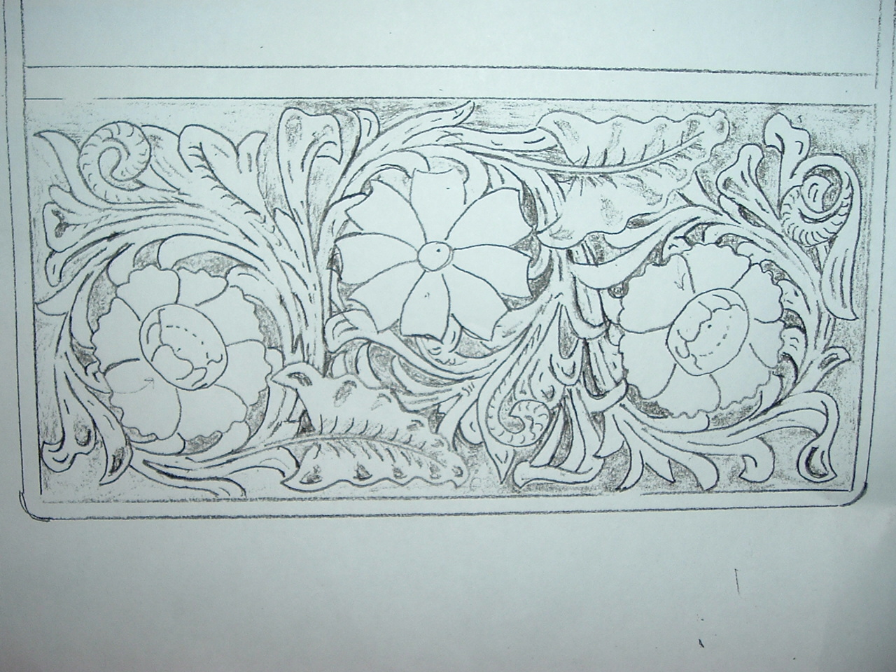

Members Chuck Posted January 14, 2008 Author Members Report Posted January 14, 2008 Chuck- nice work. You have a feel for drawing that I struggle with- I'm envious!As far as the shaders... I would get a pear shader with very fine horizontal lines. I got one from Hidecrafter in their catalog under the SHERIDAN tools. Not expensive by Barry King et al prices but well worth it. Hint!- do all of your pear shading on the leaf tips deeply and draw(walk) the shader down towards the center. THEN go back and make 1 wack with the lined shader at the tip. again- nice work! ps- draw a pattern for me- I'de love to try it and post it. pete Pete, I found the original of the one that I tooled and will put that up too. Chuck Quote
