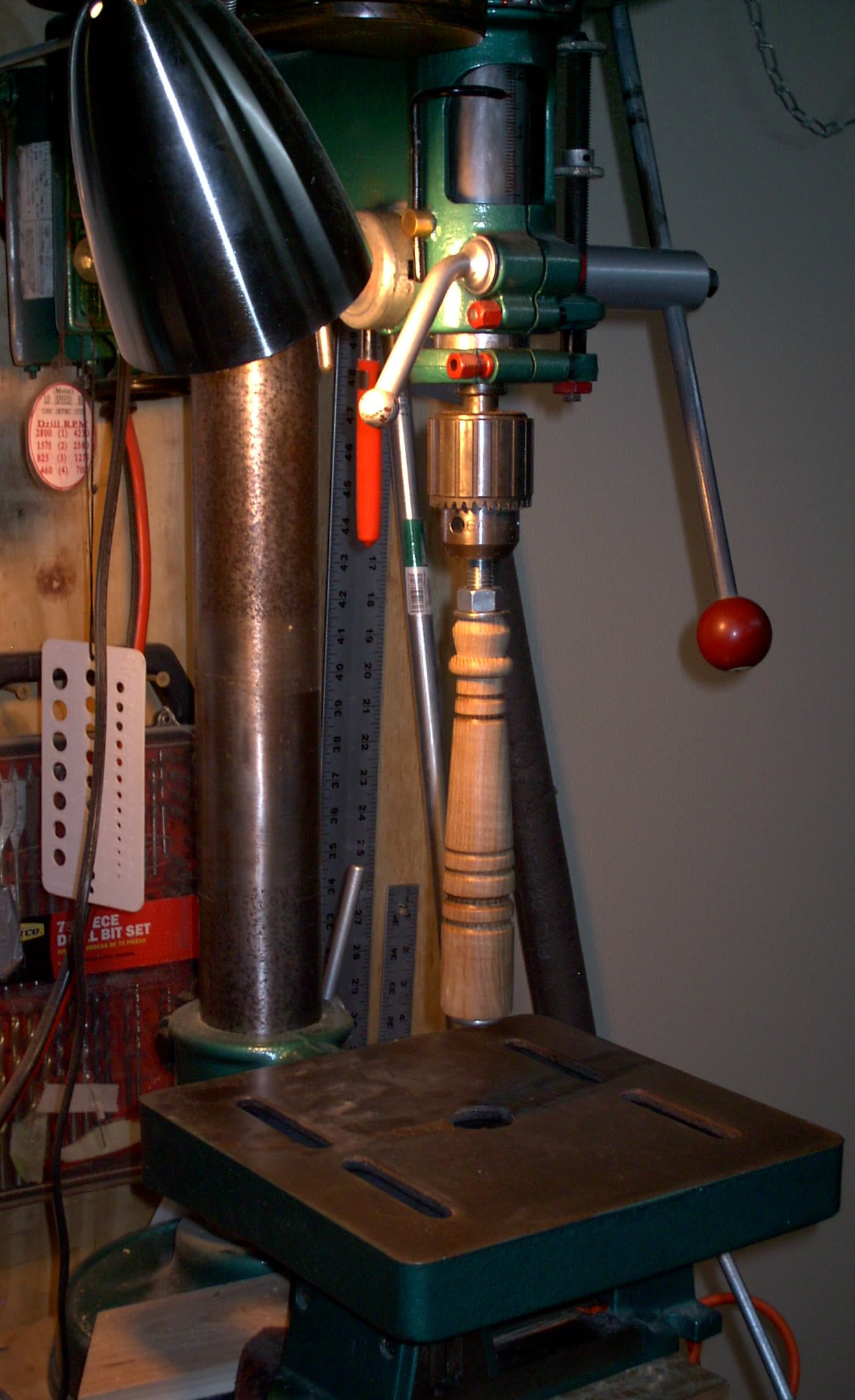

Members tazzmann Posted April 17, 2008 Author Members Report Posted April 17, 2008 As an update, I found some wooden thread spindles at Michael's craft store. I took them home and put a bolt through the middle with a nut to hold the bolt in place. I chucked up the end of the bolt into my drill press and proceeded to take a piece of 80 grit sandpaper and true it up. I then tested with a scrap piece of leather and it worked GREAT! I went back to Michael's and picked up a couple more of various sizes and worked through the process again of bolting and truing them up. Best part was they were about $.89 a piece and I didn't have to put hardly any side pressure on them. This means it won't hurt the drill and I have a fast, efficient way of slicking the edges. I tired both water and Gum Trgacanth and they both came out beautifully. Slick and shiney! Thanks for the tip Jordan! Quote Michael S Tully Vancouver, WA Night Owl Leather [url="http://www.nightowlleather.com"]http://www.nightowlleather.com[/url] [url="http://www.kz650.info"]http://www.kz650.info[/url]

BearMan Posted September 22, 2008 Report Posted September 22, 2008 Hi Tazzman, I did almost the same thing with a short table leg I got from Home Depot. It's about 10" long, & I drilled a 1/2" hole through it, inserted a 1/2" carriage bold & nut. It works great! & it has 5 diff. positions to slick on, with diff. diameters, & widths. Ed Has anyone converted a bench grinder to hold an edge slicker? Seems it would work as well. Remove the safety shield so you have room to work. You can put the slicker on one side, the horse hair on the other and end up with beautiful edges in one quick station. Quote Ed the"BearMan" polarb1717@aol.com Beary: BearMauls@yahoo.com http://tinyurl.com/BearMauls "The Best tooling mauls available today!"
