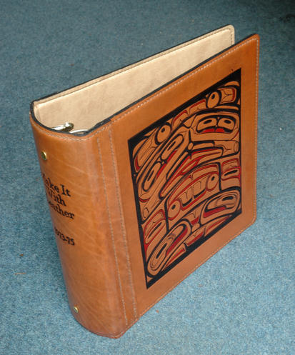

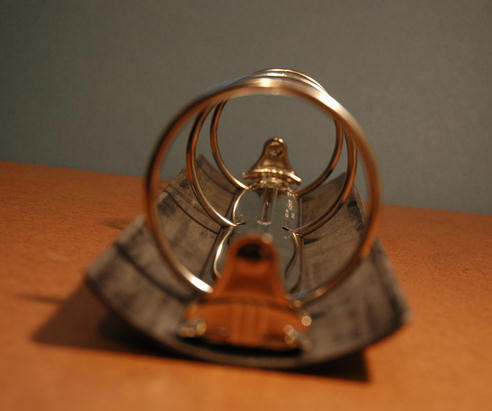

I have made several LARGE three ring binders to hold my entire collections of "The Leather Craftsman", "The Craftsman", "Make It With Leather", and "Leather Craftsman and Saddlers Journal". To hold the weight and make them rugged, I used 3-inch rings from old binders that had "pin and socket" meeting points vice those "zig zag cut" meeting points. Also, the spine is made from a section of ABS plastic gutter cut to size.
There are two articles that describe the details at:
http://pslac.org/member/NW_Indian_3-ring_binder.pdf
http://pslac.org/member/3-ring_binder.pdf
These two pictures should give you enough information to give it a try:
Hope this helps.
