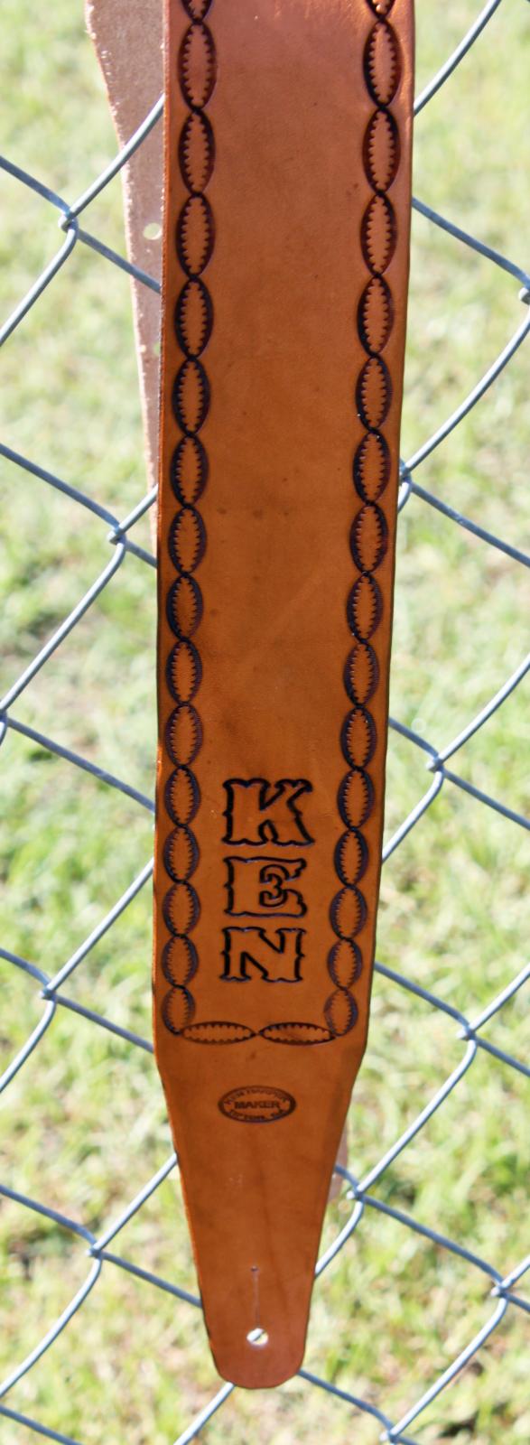

Chief31794 Report post Posted October 6, 2012 I use them to lay out borders on say guitar straps, I set them to the width of a large veiner, then make a mark where the end of the veiner will go by placing a T-Square on the edge of the leather and moving it along as I use the divider to mark the ends at a specific measurement from the edge. That allows you to have a perfectly straight border without any layout lines however light they may be. The small marks at the edge are obliterated by the end of the veiner. I also use them to keep basket weave even and straight by setting the divider to the double the width of the basket weave stamp and then lightly scribing a line so that each line of basket weave has an alignment line on one side of the tool or the other, that keeps them from wandering and works for straight as well as angled basket weave. I also use it to scribe a line for to align my thonging chisel so that my lacing is even around the edge of a project. As said above, this is one of the most versative tools in the shop, particularly for laying out designs. Quote Share this post Link to post Share on other sites
