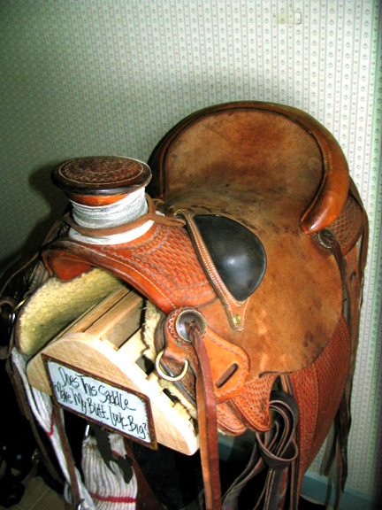

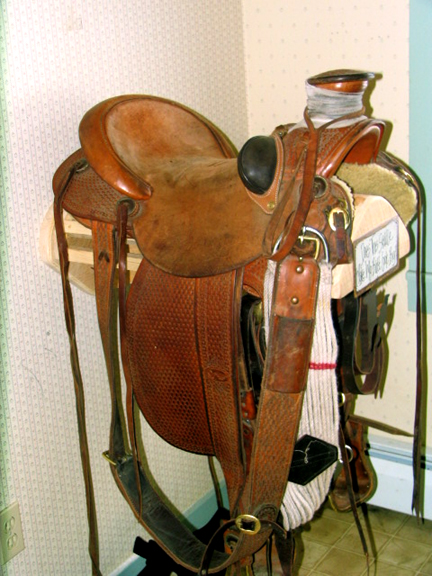

Members Newfman Posted February 26, 2010 Members Report Posted February 26, 2010 Hey folks, Tried to 'search' for some answers and found everything except the things i was searching for. Haven't found the secret for the search tool on this site. Anyway, I finally found a hand made Wade saddle that I like and that appears to fit my horse, (so far). This saddle was made by Bob Beecher of Outwest Saddlery in Pagose Springs. It is a custom built, oil finished saddle built in 2004 and delivered in 2005. It has found its way to me and I really like everything about it except: 1) I have to figure out how to give it a good clean up, and 2) The woman that it was built for evidently had some serious legs! Whoda' thunk. Yup, I can put my feet flat in the stirrup sort of, but cannot put any weight down while seated. The leathers can't be shortened anymore by anymeans, because the fenders are too long. I talked to Bob on the phone and he will make a new set of fenders and leathers, and rough-out will be the most economical at this time. I can make a tooled set as my first "real" project, once I get to the point that I am ready to start working leather. The color difference is going to be night and day. I understand that I can put the leathers and fenders out in the sun to darken them some. Do you oil them first, or does it matter? Any other reccomendations for getting a better match? Does leather reach a point that it is basically done darkening so that the newer leather may catch up? I am attaching photos. I would like to freshen up the seat a little and remove some stains, but, it is a working saddle and I think it has character. It needs a definite clean-up. Some of the tooling is caked with dirt. My plan is to scrub it with Murphys oil soap and some light brushes. I can do it in the basement, as it is winter here. Do you need to rinse it with a hose? Just a clean damp sponge and fresh water? or what? Being winter in Maine, the whole hose thing isn't really practical. My plan was to use olive oil on it for the finish, is that ok? What about the roughout seat? Does it get the same treatment? Should I wait until the saddle is completely dry? I'm wondering if we may someday get a sticky thread on saddle leather care, cleaning, rejeuvinating for both tooled and rough out leather. I know these things have been answered, but when I search things like 'cleaning leather' I get links to "nice clean lines on that saddle Bob!" And a hundred variations. I have tried a variety of search specs. So, sorry for having to bug you on this. I plan to hold on to the original leathers in case I sell the saddle someday, I will be able to make it all original. thanks for the help. Quote With enough leather and rope, you could probably make your horse cut a deck of cards. . .but you'll never make him deal 'em with a smile on his face!

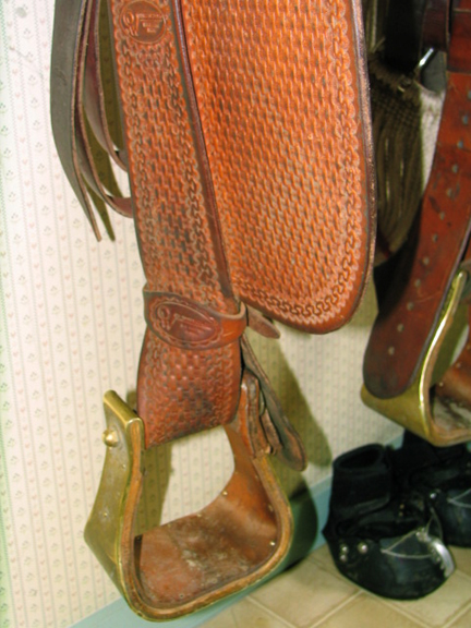

Members AndyKnight Posted February 26, 2010 Members Report Posted February 26, 2010 You have a lot of stirrup leather that can be taken up below those fenders. The botom fold where the strirrup hangs should only be maybe 2 inches belowthe fender. Not sure if that will make it work for you or if you already adjusted that. Otherwise you could sure rebuild those to where any cuts/adjustments would be hidden. Quote Andy knight Visit My Website
Members AndyKnight Posted February 27, 2010 Members Report Posted February 27, 2010 You would have to shorten the end where the buckle is riveted in. Shorten to as little as 10-11" Quote Andy knight Visit My Website
Members Newfman Posted February 27, 2010 Author Members Report Posted February 27, 2010 (edited) Sorry, that picture is a little misleading. There is a strap that goes around the stirrup leather and I have that removed. the leather makes a turn after it goes through the stirrup, and that turns the stirrup out. If I raise the stirrup any higher by adding holes for the buckle, I would not be able to twist the leather and certainly would not be able to put the strap back on. I will try to get a photo tomorrow. To tired now from work. The other issue is the fender is pretty much right up to the bars, so, there is no room on that end either. Edited February 27, 2010 by Newfman Quote With enough leather and rope, you could probably make your horse cut a deck of cards. . .but you'll never make him deal 'em with a smile on his face!
Members AndyKnight Posted February 27, 2010 Members Report Posted February 27, 2010 (edited) Sorry, that picture is a little misleading. There is a strap that goes around the stirrup leather and I have that removed. the leather makes a turn after it goes through the stirrup, and that turns the stirrup out. If I raise the stirrup any higher by adding holes for the buckle, I would not be able to twist the leather and certainly would not be able to put the strap back on. I will try to get a photo tomorrow. To tired now from work. The other issue is the fender is pretty much right up to the bars, so, there is no room on that end either. You would have to rework the twist , After shortentening the end where the buckle is .and reattaching the buckle you would have to soak and then retwist allowing them to dry in the correct position. I am guessing by the pic that you would probably gain 2-3 " for shorter inseam without shortening the fender. Not sure if that explains it or not..... . Andy Edited February 27, 2010 by AndyKnight Quote Andy knight Visit My Website
Members Newfman Posted February 27, 2010 Author Members Report Posted February 27, 2010 The picture is certainly worth a thousand words. How long would you soak it for, and I assume that it won't stain it. (?) So, just soak the ends i am working or is it better to remove and do the whole thing? Sounds like a stupid question, but I don't want to have a little color shift where the dry-v-soaked sections are. I need to investigate proper rivets, tool and removal of old and reinstallation of new rivets. Hmmm, grind them with a dremel, or drill them? I have a feeling my wife will be just shy of being able to use this saddle. She will likely be where I am now. We'll see. Out of curiosity, just how long are "standard" fenders, generally speaking. As in, for people that aren't requesting extra long. Or is every fender made per saddle per person and nobody uses a pattern for them? Quote With enough leather and rope, you could probably make your horse cut a deck of cards. . .but you'll never make him deal 'em with a smile on his face!
Members RWB Posted February 27, 2010 Members Report Posted February 27, 2010 (edited) The picture is certainly worth a thousand words. How long would you soak it for, and I assume that it won't stain it. (?) So, just soak the ends i am working or is it better to remove and do the whole thing? Sounds like a stupid question, but I don't want to have a little color shift where the dry-v-soaked sections are. I need to investigate proper rivets, tool and removal of old and reinstallation of new rivets. Hmmm, grind them with a dremel, or drill them? I have a feeling my wife will be just shy of being able to use this saddle. She will likely be where I am now. We'll see. Out of curiosity, just how long are "standard" fenders, generally speaking. As in, for people that aren't requesting extra long. Or is every fender made per saddle per person and nobody uses a pattern for them? You won't have to soak the leather to long. Just so it's pliable. If it's not enough put a little more water to it. I would just soak what you need to twist, and not be to bothered about a color change. Even if you do get a little bit of a water mark (which sometimes happens) your never going to see it. Especially if you are going to clean and oil this saddle afterwards. You want a #9 copper rivet with burrs. I either grind out the old rivets or drill them out, whatever works. You will also need a rivet setter. Bob Douglas sells them. Or you might be able to go to your local Tandy store and buy both the rivets and the setter. Fenders and stirrups leathers run all different lengths. Most custom saddle makes take an inseam measurement. If I build a saddle just to sell and not for a custom order, I try to pair the length of the fenders and stirrup leathers with the length of the seat. A 14" seat typically won't fit a 40" inseam. Hope that helps Ross Brunk Edited February 27, 2010 by RWB Quote Ross Brunk www.nrcowboygear.com
Members AndyKnight Posted February 27, 2010 Members Report Posted February 27, 2010 The picture is certainly worth a thousand words. How long would you soak it for, and I assume that it won't stain it. (?) So, just soak the ends i am working or is it better to remove and do the whole thing? Sounds like a stupid question, but I don't want to have a little color shift where the dry-v-soaked sections are. I need to investigate proper rivets, tool and removal of old and reinstallation of new rivets. Hmmm, grind them with a dremel, or drill them? I have a feeling my wife will be just shy of being able to use this saddle. She will likely be where I am now. We'll see. Out of curiosity, just how long are "standard" fenders, generally speaking. As in, for people that aren't requesting extra long. Or is every fender made per saddle per person and nobody uses a pattern for them? I build for 5'8"- 5'6" 17" 5'8" -5'10" 18" These will vary somwhat and are approx. and will depend on inseam and riding style. If you soak everything below the fender you will find it the easiest and will probably not get a noticeable water mark. Reoil the whole saddle when done. It may take a while ( half hour or so) to get the leather wet enough . It will depend on the oill content in the leather. You can usually drill the rivets out. although if I am cutting off the leather where it is riveted I will grind them of . Quote Andy knight Visit My Website

Members Newfman Posted February 27, 2010 Author Members Report Posted February 27, 2010 I am 5'8 and 1/2" (gotta add the half) with a 30" inseam. the saddle is a 15 1/2" seat. The full length of the fenders are 20". Add 6.5 inches from the top of the fender (base of the bar) to the mid-line of the seat and that leaves only 3.5 inches for the stirrup leather at the base of the fender to turn and the depth of the stirrup itself. Coming up a little short. I'm developing stirrup envy. Quote With enough leather and rope, you could probably make your horse cut a deck of cards. . .but you'll never make him deal 'em with a smile on his face!
