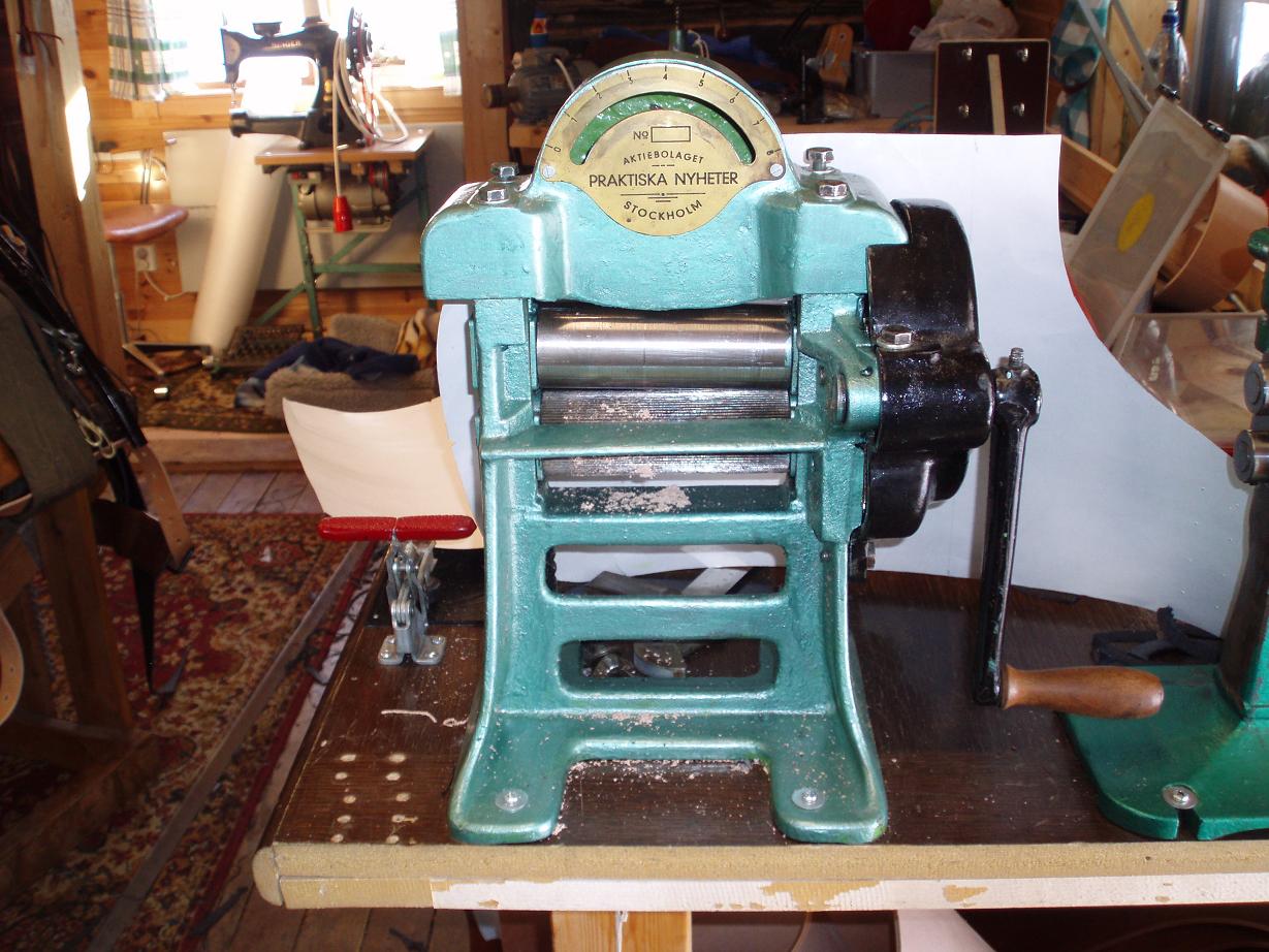

I have a twin to your machine, the nameplate has a company name from Stockholm, but It seems that my machine comes from the same manufacturer as yours .
/ Knut

Hi. When I took a closer look it was not a twin, but I suspect my machine to be a W. Pedersen from Denmark. The Stockholm based company imported many of Pedersens machines under their own label.
Here is a pic of my splitter. The adjustment handle is broken and I have sent it to be welded, but it is similar to yours, with a wing nut lock. Sorry, no manual.
/ Knut

Thanks guys. Knut, your splitter looks very similar to mine but the main casting is slightly different. More like the Landis than the solid casting mine has:
