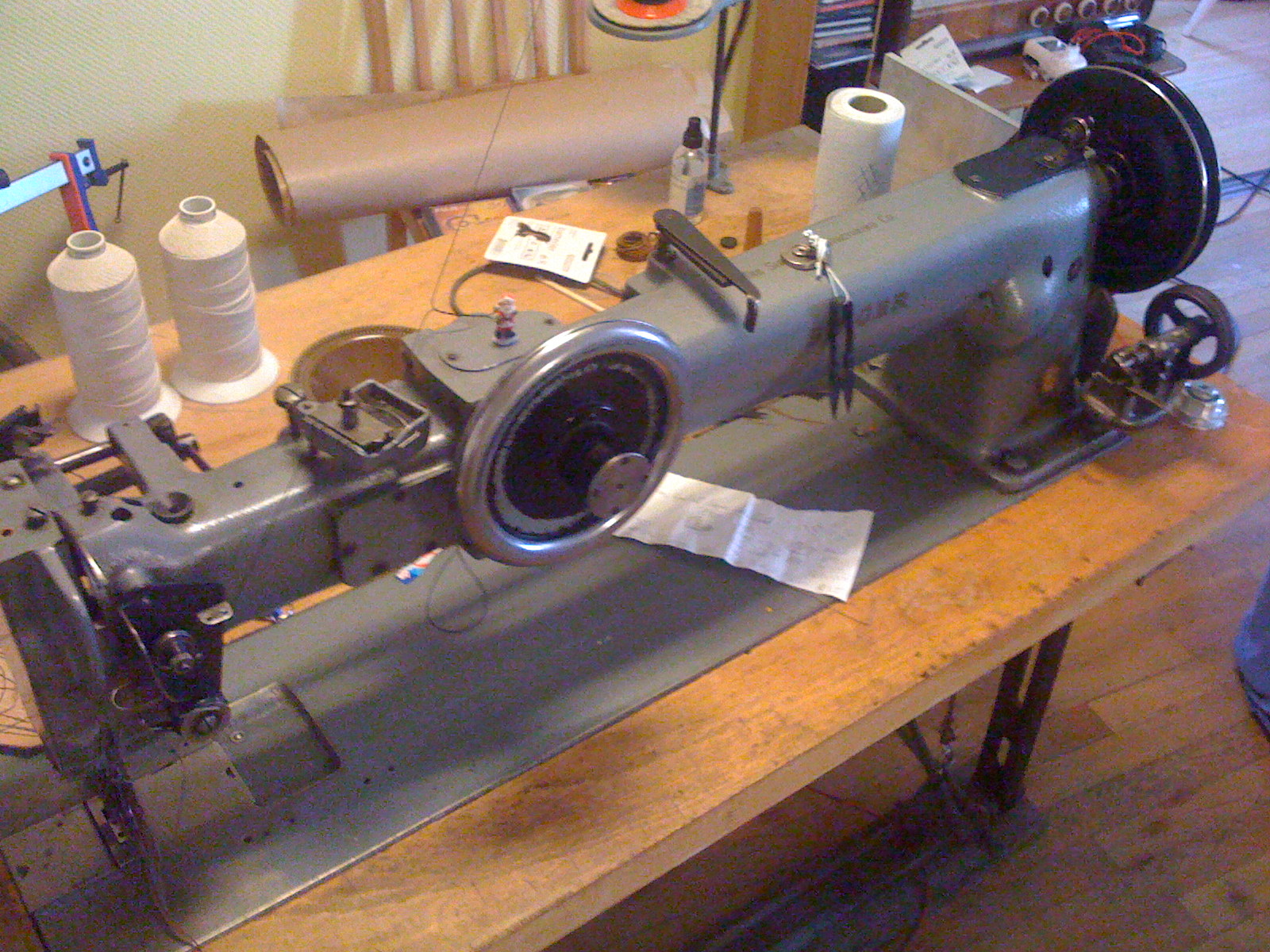

Here is a pic of my 144w 305
Trox

Trox, what is the purpose of that Santa Clause figure on top???
Hi Nelson, That's a red smurf, one of the machine operators that came with the machine. There was a hole bunch of them that worked on this huge machine. The others had lunch when I took the photo. When I sold the machine they left too :)
