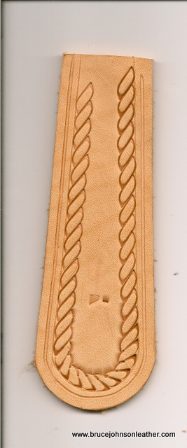

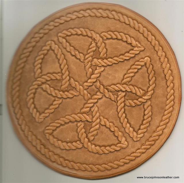

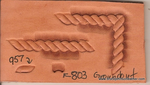

Moderator bruce johnson Posted September 23, 2010 Moderator Report Posted September 23, 2010 I use rope borders quite a lot. I run mine with just an outside guideline. I try to run at about a 45 degree angle. I bevel the rope, and have made bevelers from cheap Tandy stamps to match the curve of the different rope stamps I have. Just take a round stone on a Dremel and grind a curve in the toe of the stamp to match. I am attaching a few examples. One is the 90 degree corner, and how I tip to get the corner. The next is a Celtic pattern I did for a stamping deal we had here a few years ago. The only Celtic thing I have done, it was kind of fun. I forget who but someone asked me off forum a year or two ago for some help with tight curves with the rope border. I knocked one out pretty quick as an example of how I do those on a sample bridle cheek. In a nutshell I stamp a full impression on the outside of the curve and tip the stamp to do a partial and shorten up the inside. It is a little tricky to keep the angle right, but after a while you kind of get a feel for it. Quote Bruce Johnson Malachi 4:2 "the windshield's bigger than the mirror, somewhere west of Laramie" - Dave Stamey Vintage Refurbished And Selected New Leather Tools For Sale - www.brucejohnsonleather.com
