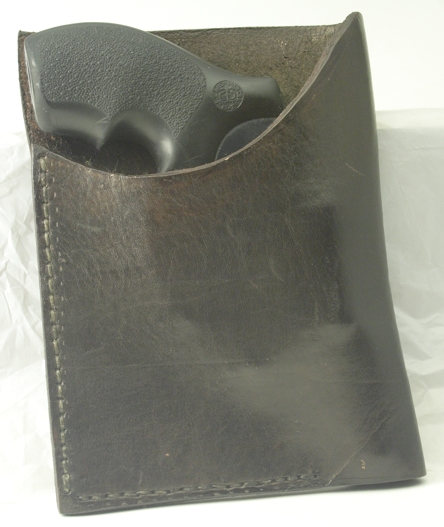

Deanimator Report post Posted October 22, 2010 I don't do any forming on mine. They're rectangular like a wallet to conceal the outline. I've had no retention problems in using one nearly every day for months. Quote Share this post Link to post Share on other sites
