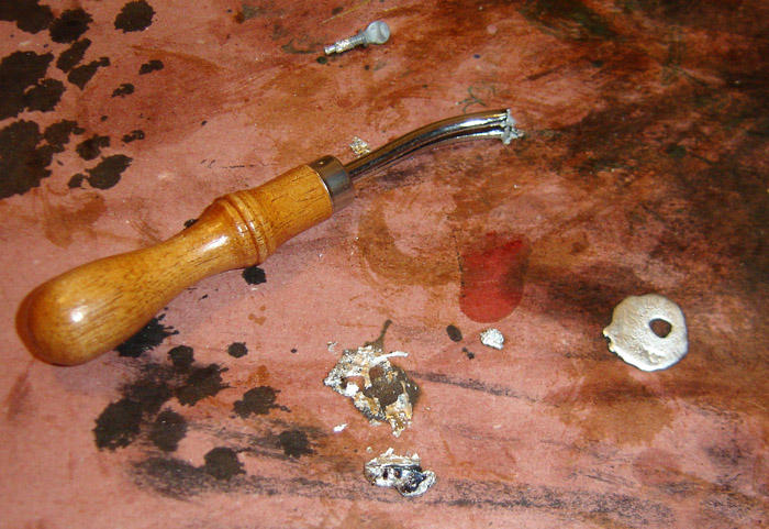

Members BAD HIDE Posted October 28, 2010 Members Report Posted October 28, 2010 Ya know all those pics and such you see of guys heating an edging tool with a torch? yeah, those tools must be made better than mine. This was done with a regular propane torch, ya know the kind where you have to hold it for 10 minutes to just get steel red hot, first couple heatings I noticed a little metal bubble up and flake off, so I'm thinking it was just the plating coming off, no biggie. Go to heat it up again (couldn't have been more than 10 seconds) to get a good long groove on a belt and ploop, I'm out an adjustable edge groover. Ignore the dye mess on the paper. Friggin cheap tools must be made out of pewter or something. Quote Badhide.com
Members whinewine Posted October 28, 2010 Members Report Posted October 28, 2010 (edited) On 10/28/2010 at 4:17 AM, BAD HIDE said: Ya know all those pics and such you see of guys heating an edging tool with a torch? yeah, those tools must be made better than mine. This was done with a regular propane torch, ya know the kind where you have to hold it for 10 minutes to just get steel red hot, first couple heatings I noticed a little metal bubble up and flake off, so I'm thinking it was just the plating coming off, no biggie. Go to heat it up again (couldn't have been more than 10 seconds) to get a good long groove on a belt and ploop, I'm out an adjustable edge groover. Ignore the dye mess on the paper. Friggin cheap tools must be made out of pewter or something. The osborne ones are safe, & they even say so (at least for the rolling wheels with the design on them). The tandy ones don't say that, so one must assume that they are not safe to heat (as you well proved). If, however, this was simply an adjustable edge marker, the kind without the wheels, I don't know how heat safe that kind is, either Osborne or Tandy. Edited October 28, 2010 by whinewine Quote
Contributing Member TwinOaks Posted October 28, 2010 Contributing Member Report Posted October 28, 2010 I know it isn't funny to be out a tool......but that's just hilarious. Look at the bright side- you now have a handle for a custom built tool. And it'll match all the other ones! On second thought, maybe you should send that back to Tandy, I'd love to hear their explanation for it. Quote Mike DeLoach Esse Quam Videri (Be rather than Seem) "Don't learn the tricks of the trade.....Learn the trade." "Teach what you know......Learn what you don't." LEATHER ARTISAN'S DIGITAL GUILD on Facebook.
Ambassador Luke Hatley Posted October 28, 2010 Ambassador Report Posted October 28, 2010 On 10/28/2010 at 9:44 AM, whinewine said: The osborne ones are safe, & they even say so (at least for the rolling wheels with the design on them). The tandy ones don't say that, so one must assume that they are not safe to heat (as you well proved). If, however, this was simply an adjustable edge marker, the kind without the wheels, I don't know how heat safe that kind is, either Osborne or Tandy. ********************************************************************************* yes the Osborne ones are safe ? .But i dont beleive there is anything written or to be understood that it NEEDS TO BE HEATED RED HOT TO DO WHAT YOU TRIED TO DO. i have HEATED my edge creasers with a heat gun with complete sucess. Quote Luke
Contributing Member Jordan Posted October 29, 2010 Contributing Member Report Posted October 29, 2010 Bunsen burner, alcohol lamp or even a zippo should be sufficient, just beyond warm is all that is needed as far as I can tell. But I am no expert and don't personally use heat. I found that casing and repeated pressure as if burnishing an edge works fine for me. Sorry for your loss. Quote
Members BAD HIDE Posted October 29, 2010 Author Members Report Posted October 29, 2010 (edited) On 10/28/2010 at 1:08 PM, Luke Hatley said: ********************************************************************************* yes the Osborne ones are safe ? .But i dont beleive there is anything written or to be understood that it NEEDS TO BE HEATED RED HOT TO DO WHAT YOU TRIED TO DO. i have HEATED my edge creasers with a heat gun with complete sucess. I wasn't going for red hot, just hot enough to do a fair stretch on a dry belt. I haven't done it very often, so I was still trying to find what temperature and # of passes would give a good edge. I don't have a heat gun, just a propane torch and oxy/acetylene - which wouldn't be any better. Seeing this, I wouldn't even try a Bunsen burner. It might have been aluminum or tin or some other crappy alloy, but it definitely wasn't decent steel. I just was not expecting in a million years to melt it so easily and quickly - it didn't even cross my mind that it was in the realm of possibility. This post is more of a warning to anyone who does it this way, or hasn't yet tried it but might. I'm still kinda shocked that they'd make something so cheaply and still call it a tool. Oh, and I'm not mad. It really is quite funny. Edited October 29, 2010 by BAD HIDE Quote Badhide.com
Contributing Member TwinOaks Posted October 29, 2010 Contributing Member Report Posted October 29, 2010 I can't help but wonder if there's some stamp maker in _______(wherever they get them made now) laughing and thinking "Let's see 'em burn the chrome off THIS!" Quote Mike DeLoach Esse Quam Videri (Be rather than Seem) "Don't learn the tricks of the trade.....Learn the trade." "Teach what you know......Learn what you don't." LEATHER ARTISAN'S DIGITAL GUILD on Facebook.
JerryLevine Posted October 30, 2010 Report Posted October 30, 2010 On 10/28/2010 at 4:17 AM, BAD HIDE said: Ya know all those pics and such you see of guys heating an edging tool with a torch? yeah, those tools must be made better than mine. This was done with a regular propane torch, ya know the kind where you have to hold it for 10 minutes to just get steel red hot, first couple heatings I noticed a little metal bubble up and flake off, so I'm thinking it was just the plating coming off, no biggie. Go to heat it up again (couldn't have been more than 10 seconds) to get a good long groove on a belt and ploop, I'm out an adjustable edge groover. Ignore the dye mess on the paper. Friggin cheap tools must be made out of pewter or something. Sorry to see you've come off with a busted tool. I use one of these http://www.josephdixon.co.uk/products/Saddlers_Tooling/Screw.html which are all steel. I've been to the place where they make them by hand (which is why they're expensive!!), so I'm happy they'll hold up. I use a camping gas stove heat to my crease. I don't think you need to get them red hot to make a permanent mark, but it depends on the effect you're trying to create; I did a lot of experimentation before I did a line for real. I've filed down and re-shaped the inside blade (left in my case - I'm right handed; right blade though, if you're left handed), so that there's more hanging over the edge of the leather to reduce the chance of me slipping and making a permanent mess. Good luck with your new crease, if get another. All the best. Jerry Quote All the best, Jerry "There is nothing better for the inside of a man than the outside of a horse" Will Rogers 1879-1935 quoting Sir Winston Churchill 1874-1965
