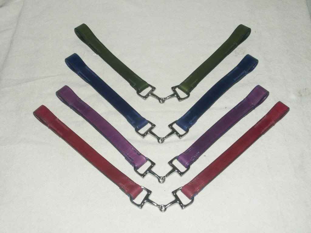

JLSleather Report post Posted November 28, 2010 Too kind, Ann, but thanks Personally, I prefer natural leather with a hints of color. Hate to see perfectly good cow all painted up. But, my wife says - about 2 or 3 times a week - kaint just make what I like. So, the dark leather was her idea, actually. I have 16 bottles (1 0z) that I have stuff pre-mixed in, and 4 more (same size) that I have around for mixing the stuff I'm just gonna use once (I don't do lots of purple, but even I liked those purple orchids that lady wanted). This is why I say "about" 4:1 or "about" 30:1 ... I know some of the reducer is evaporating when the bottle is open. Bottles are about 1 3/8" diameter, I git the dye with droppers. They're about $2 / 5 pack at hobby lobby, and I keep them separated - one for yellows, one for reds .... etc. All of it sits in a small drawer in my bench and slides shut out of the way when I'm tooling. Just for information, the bottles I use are 1 oz glass bottles by Paasche, who also makes the airbrushes I use. Hobby lobby has those, too, or you can get them on Ebay for about $1 apiece. Glass bottles will clean out very well if you ever decide to clean 'em, and you can use them with the airbrush if you care to (I don't - too much weight for me when I'm trying to be able to move around). The "thingy" posted here is all done with shades of those 16 colors, though some of the shades are more than one color painted over the top of another. I post it here so you can see what the 30:1 blue looks like (sky, water, fisherman's jeans, and lightly on the distant mountains). Quote Share this post Link to post Share on other sites
