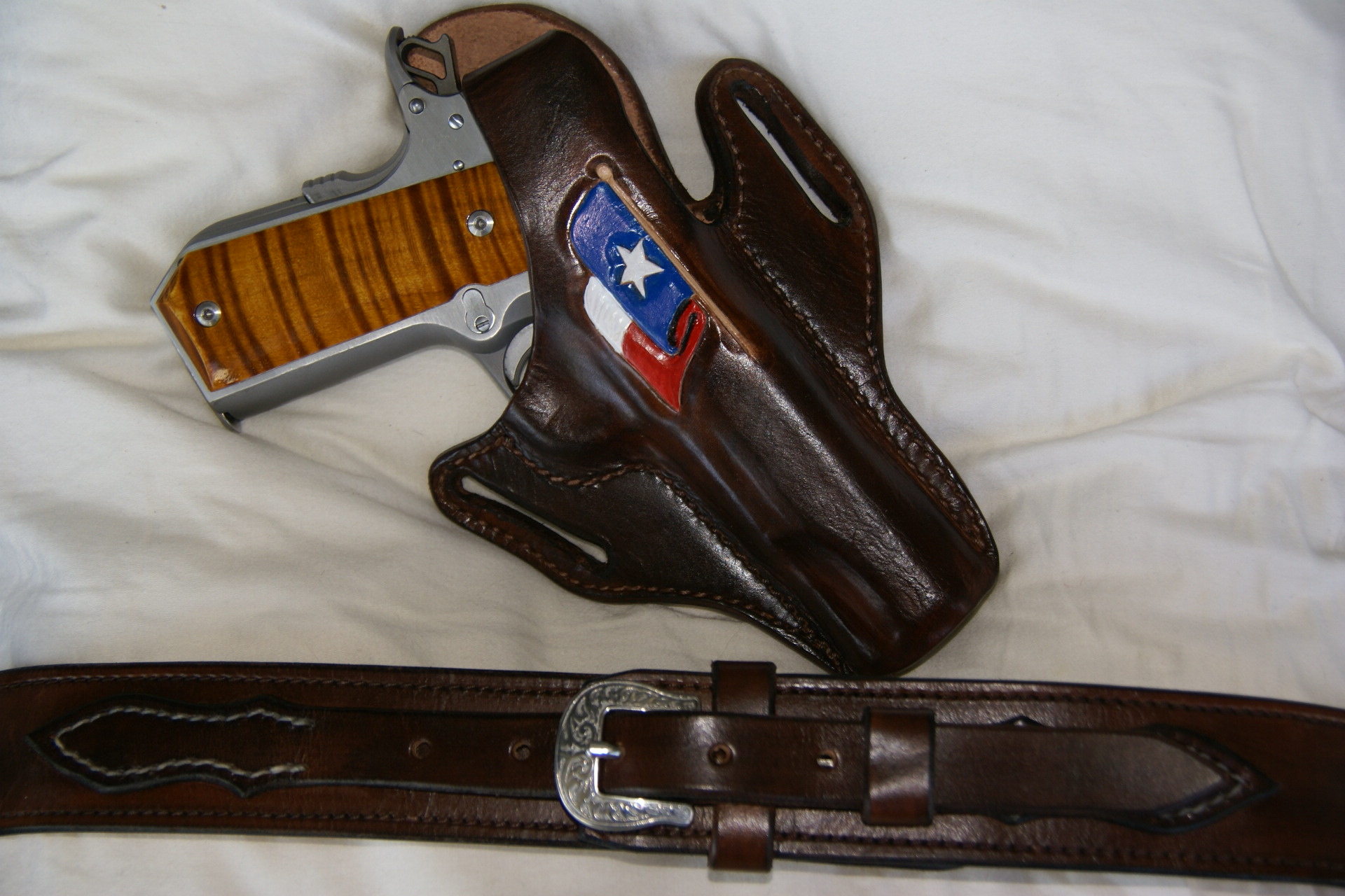

Mike Craw Posted December 17, 2010 Report Posted December 17, 2010 Yeah, I knew somebody would jump on with a source for metal stiffeners. Thanks katsass! This is a holster and belt combo I did for a buddy at work. One of the guys asked him why he wanted me to put the Puerto Rican flag on it. My Tejano buddy Adrian certainly enjoyed that little joke...not. Anyway, I build the holster and seat it cased, not wet, and do the molding. I mold the rear shirt guard/thumb break at the same time and bone the hell out of the area around the thumb safety in the on position until it fits into its own notch. I rough form the front strap and let the whole thing dry. Once dry, I set the thumbreak snap half (female) above the area where that safety sits and then stretch the front strap under there. Once I get that ring impression from the female half I set my awl on the tight side of the center of the circle and set the male half. Adrian rides this rig on his Harley to work, and if it had loosened up any, I would have heard about it! Mike Quote
