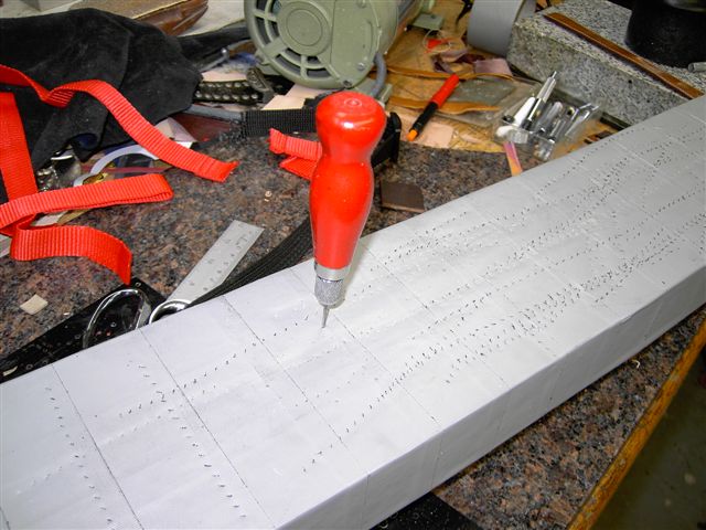

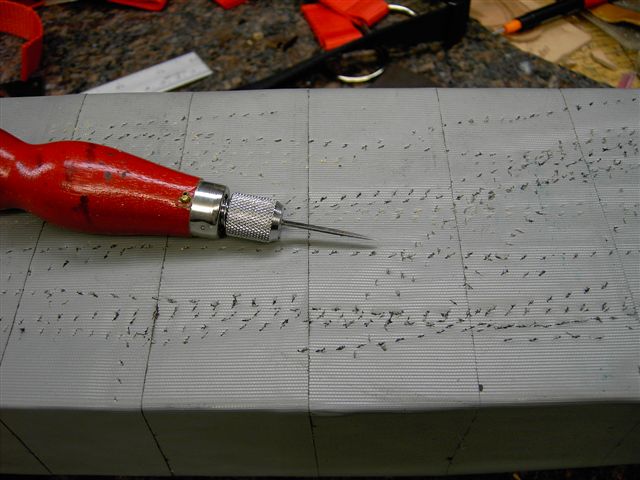

JRLeather2 Posted May 8, 2008 Report Posted May 8, 2008 I made my own punching board, just for hand stitching allows me to punch deep holes without much effort and it is also pretty stable when laying flat on my bench. It is made out of that blue foam insulation and duct tape! Quote

Members CitizenKate Posted May 23, 2008 Members Report Posted May 23, 2008 The diamond hole punch will make holes that are much too big, but they're great for marking where the holes should go. Then use an awl to make the actual holes. I use the awl exactly the same way as Jeffzilla. The only difference is, I just use a couple of pieces of foam core. I tried the method in Al's book, where you're juggling two needles and the awl at the same time, and that just did not work smoothly at all for me. Punching the holes all at once while the project is laying on a flat surface works much better. Kate I made my own punching board, just for hand stitching allows me to punch deep holes without much effort and it is also pretty stable when laying flat on my bench. It is made out of that blue foam insulation and duct tape! Quote
