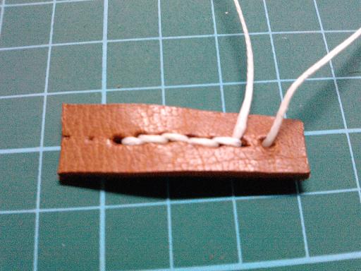

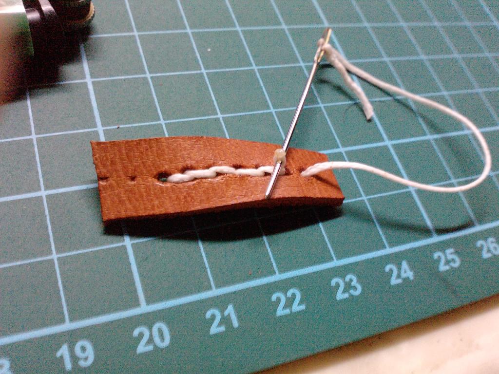

reddevil76 Posted December 27, 2010 Report Posted December 27, 2010 Instead of cutting 2 ends, and burning them off. I looped both ends together, and burn into one. But it still leaves an ugly one. Is there any hidden method where no ends can be seen? I tried stuffing this one end into the stitch hole with a blunt awl, but to no avail. Quote
Members alb Posted December 27, 2010 Members Report Posted December 27, 2010 Before stitching the last hole or two take a very sharp knife - xacto works well, and make a very slight slice on the grain side of the leather, between the last two holes. Take the last stitch and gently pull on the ends of the thread to snuggle the thread down into the slit. When you backstitch one hole, the thread from that last stitch will sit on top and it will look as if there is only one thread. Burning ends works better on certain kinds of thread, and not very well on others. Is there any hidden method where no ends can be seen? Quote
reddevil76 Posted December 28, 2010 Author Report Posted December 28, 2010 Before stitching the last hole or two take a very sharp knife - xacto works well, and make a very slight slice on the grain side of the leather, between the last two holes. Take the last stitch and gently pull on the ends of the thread to snuggle the thread down into the slit. When you backstitch one hole, the thread from that last stitch will sit on top and it will look as if there is only one thread. Burning ends works better on certain kinds of thread, and not very well on others. Is there any hidden method where no ends can be seen? But when you back stitch, you still have 2 ends to deal with. Do you still burn them? Quote
Members alb Posted December 28, 2010 Members Report Posted December 28, 2010 I usually backstitch 2 stitches, cut very close, poke the ends in without burning and tap all of -the stitching softly with a round-faced hammer. If the ends really don't want to stay in place, I'll singe them. If I'm using a waxed nylon or poly I won't burn as it usually leaves a hard, sharp, knarly knot. Ann But when you back stitch, you still have 2 ends to deal with. Do you still burn them? Quote

Members skip Posted February 1, 2011 Members Report Posted February 1, 2011 When hand stitching you can hide your last stitch inside the leather and cut the ends off below the leather with a sharp knife. Most saddle makers will use the last stitch to make a lock stitch by doing a half hitch around the bottom thread some use two or three half hitch's around the bottom thread and then pull the knot into the middle of the pieces of leather you are stitching together. thus the last stitch is locked by half hitches and then when the threads are cut you make sure you cut the thread below the sureface of the flesh or finished side of the leather. I hope this will help it makes a very clean end to a stitching line. Quote

Mike Craw Posted February 3, 2011 Report Posted February 3, 2011 I do the same thing Mike does, but I would add a note of caution to the "trim as close as possible" part of it. Once I have my stitches looped and pulled tight in the hole, and the final thread from the front side pulled through the next hole to the back, I take a SHARP pointed X-Acto knife and I put the point down into the hole resting on the stitch with the sharp edge against the thread that's coming out of the hole. I then HOLD THE KNIFE STILL and pull on the thread, working it back and forth against the knife edge until it cuts, That way you will not cut a stitch and have to re-do the whole thing... Anybody want to guess how I know that? Mike Quote My choice early in life was either to be a piano-player in a whorehouse or a politician. And to tell the truth, there's hardly any difference. Harry S. Truman

Members Ziess Posted March 18, 2011 Members Report Posted March 18, 2011 I was taught to finish the ends this way. Back stitch twice. Then go half way through the third stitch and out between the two pieces on both sides. Both ends should come up between the pieces of leather. Tie the ends together with a simple knot and pull tight, do this twice. Snip the ends close to the knot, leaving maybe .25 inch. Tuck everything down. Everything is hidden between the pieces of leather. No need to singe the ends. Quote
