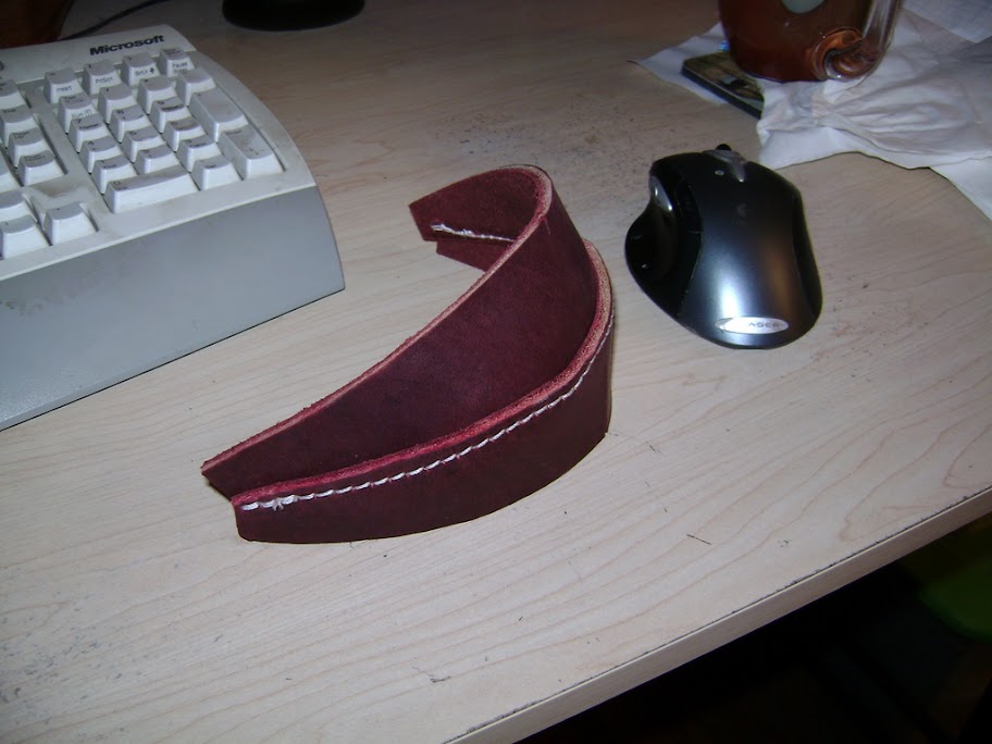

hivemind Report post Posted February 2, 2011 Playing with the Boss. This here is two lames of a helmet: That connection used to be eleven rivets and fifteen to twenty minutes of my life. With the Boss, that took less than three minutes. No hole punching, ho hammering, just some pulling on a lever. I loves me some technologies. Quote Share this post Link to post Share on other sites

hivemind Report post Posted February 6, 2011 I dunno. I haven't really made anything I'd sell on it yet, and haven't' settled on anything other than using black thread not white. Tried a whole helmet yesterday, but clearly my pattern needs tweaking for machine sewing because it's freaking HUGE. I"m going to sew up a leather bottle today and see how that goes. Quote Share this post Link to post Share on other sites
