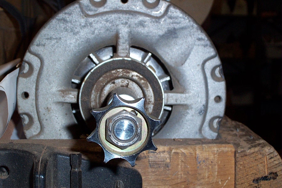

Hi,
We installed a "stitch picker wheel" on a one horse motor with an arbor attatched. There was some grinding needed for one bolt so it would fit inside the picker opening. The slower the motor moves the better it works. After cutting the soles off lightly sand the underside of the welt being careful not to hit welt stitches! Then use the picker, it will remove 80% to 90% of them. Sometimes it will remove them all, that is a good day!!
The picker can be bought from Southern Leather in Denver or maybe most shoe supply sources. I think it was about $13.50 The arbor was $18.00 and the motor was out of a old desert cooler (1750 rpm's) It needs to run slower so install a speed reducer on the cord from a fan to slow it.
I have used it on boots and saddle skirts! Makes both a quicker job!!
Ask for the 1/2inch opening for the picker and the arbor
Rick
