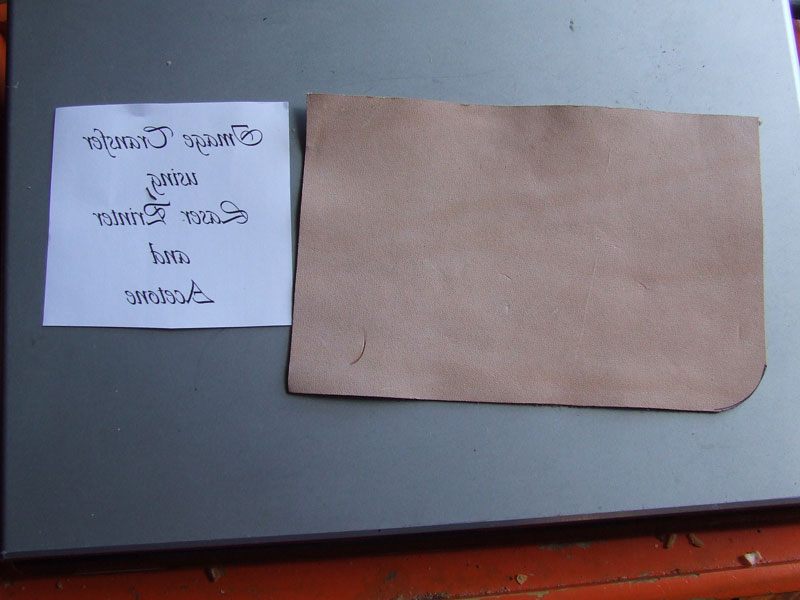

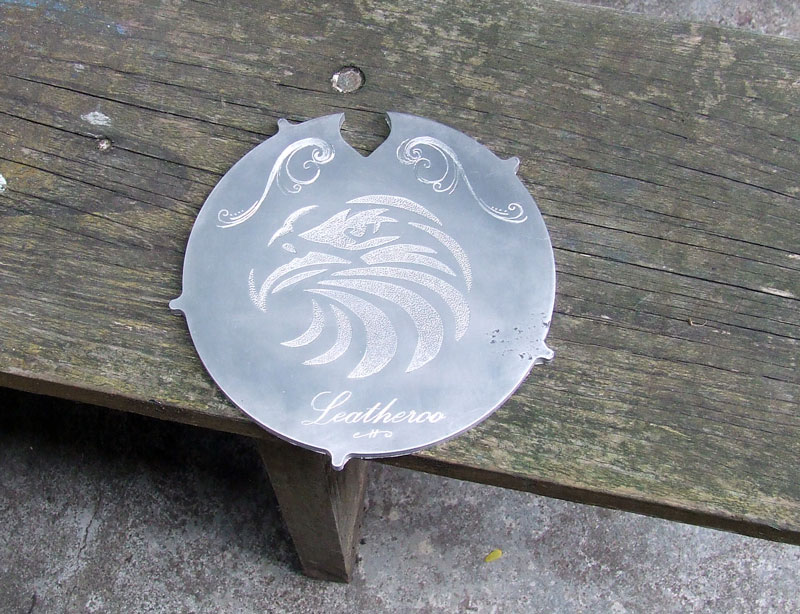

Ambassador leatheroo Posted March 26, 2011 Ambassador Report Posted March 26, 2011 (edited) I recently got myself some rotary engraving stuff and wanted to transfer a pattern to metal and after doing some googling came upon the laser printer and acetone method. The image to be used is printed..(.remember to reverse the image) on a laser printer and then placed face down on the metal. Wet a cloth with some acetone and wipe the back of the image. Then burnish the back of the picture and the picture is transfered to the metal. So i now had to try this with leather. Same process, being careful not to get acetone on the leather and here are the results. The draw back is that the image does not come off. Well i havent found anything to get it off yet. I would probably use this method if i was going to dye the finished carved project black. Also a pic of my first metal engraving and an engraved bird flourish, both done using the above method of image transfer Cheers caroline Edited March 26, 2011 by leatheroo Quote "]http://leatheroo.blogspot
Ladykahu Posted March 26, 2011 Report Posted March 26, 2011 Out of curiosity Did you just use 'normal' printer settings or did you go for one of the more 'saturated' settings? I know when I have printed directly onto fabric I always have to play a bit to get the right amount of ink saturation, so presumably if you over saturated the paper, more would come off on the leather? and, I wonder if other paper types would be better or worse? thinking glossy, or super matt, or even overhead projector film? Natalie Quote Insanity is hereditory, you get it from your kids
Ambassador leatheroo Posted March 26, 2011 Author Ambassador Report Posted March 26, 2011 (edited) Hi Nat, i just used normal settings, with cheapo supermarket paper....note i did this with a laser and not an inkjet. I originally was looking for a laser that had the fuser busted...its the fuser that sets the ink on the paper. I found this was not so easy to find, also if the fuser is not working, the printer usually wont work either...it gives error messages. With leather transfer i didnt want the image to be permanent, i wanted it for carving, to eliminate the whole tracing over the picture , then carving process. cheers Edited March 26, 2011 by leatheroo Quote "]http://leatheroo.blogspot
