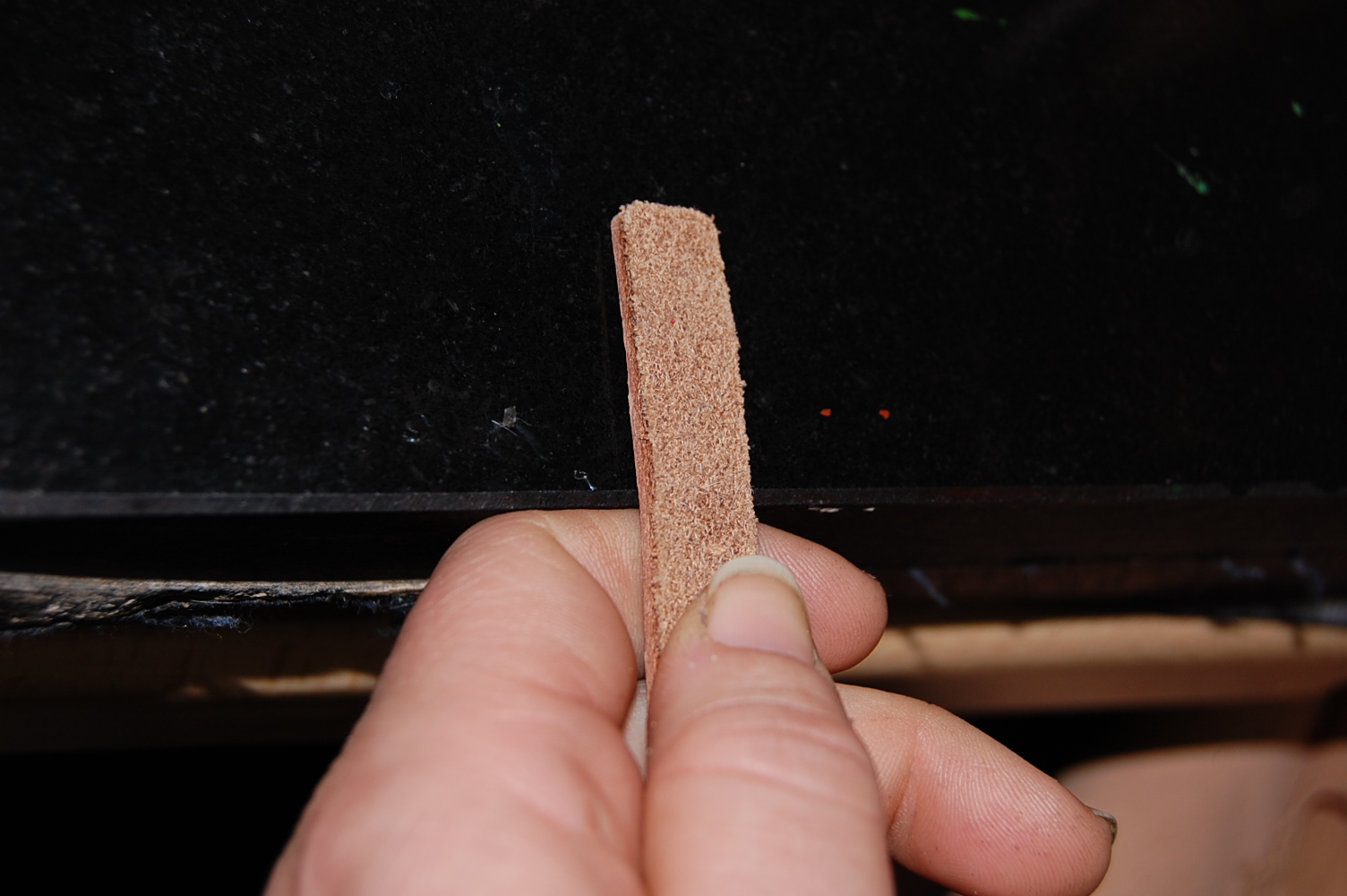

I may be caused how you hold the strip when you skive. I was tought to hold my hand low at the edge of the table. It will help to have firm and stable grip and the hand that hold the knife ( skiver or like I use a roundknive) will not interfere with the left hand.
I took two pictures without knife to show you the difference.
low at the edge
on the cutting surface

I tried holding the leather the way you showed in the pictures and it works much better! Thanks again for taking the time to help.
