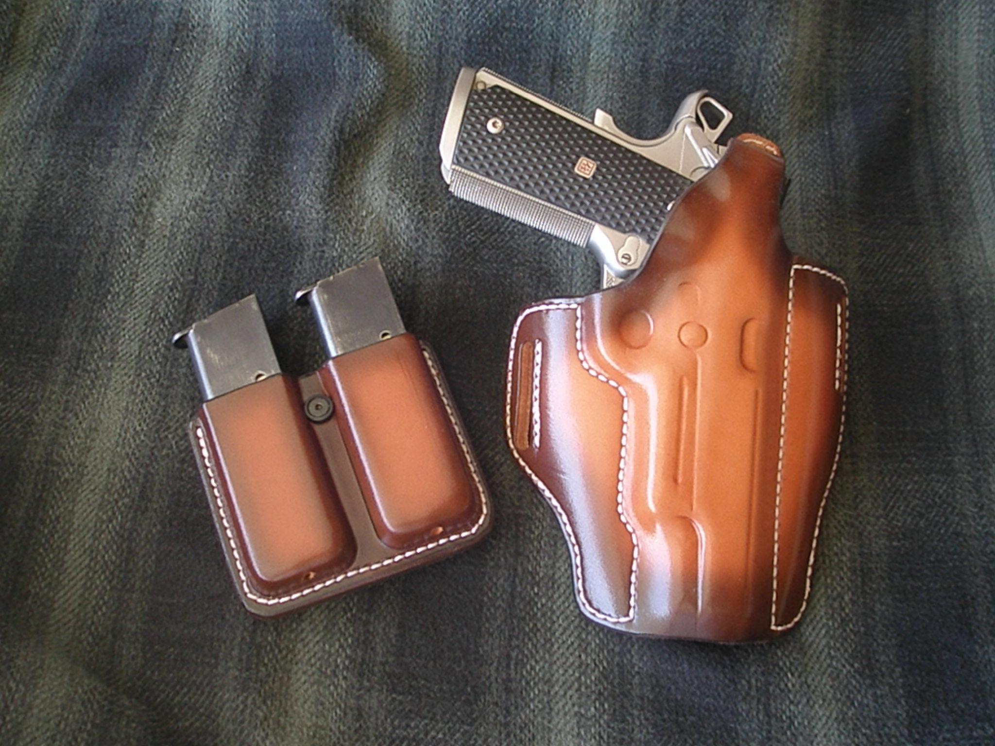

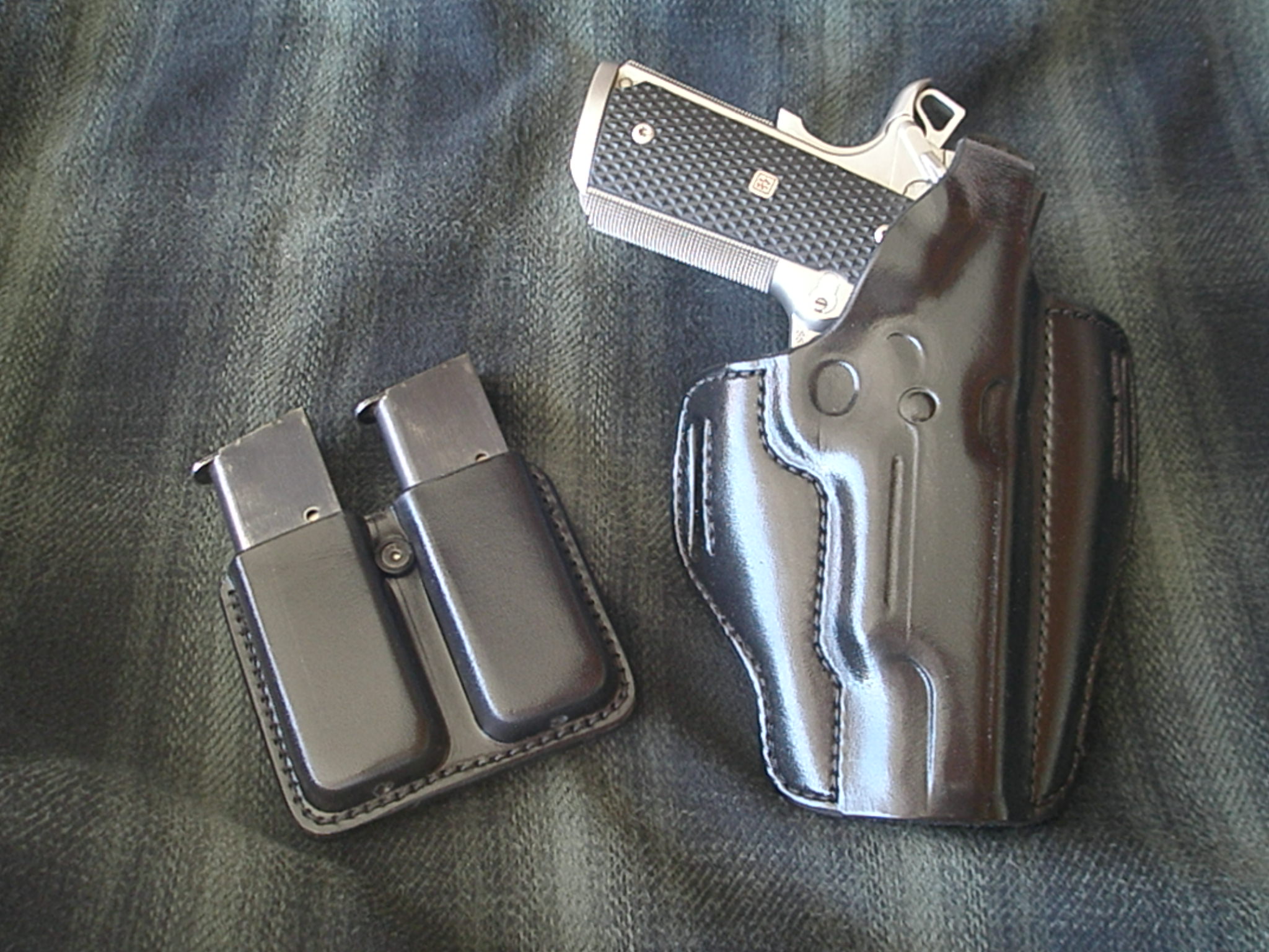

my latest holster/ammo pouch combos.

Great looking work Troop! You use wooden forms to make your mag pouches?
Beat me too it, I was going to ask the same thing. I like the 'drain' in them as well, neat detail.
thanks all. actually i bought a square foot of three inch thick HDPE (high density polyethylene) then had molds and blanks made out of it for all of the common magazines. 9mm double, 40 cal double 45 cal double and single.... the stuff is very strong and takes a 12 ton press like a champ. i would recommend it over wood anyday. it cuts like wood but is way stronger. it is expensive ( $100.00 a square foot) but if you plan on doing this for awhile it pays for itself.

Very nice!
What leather are you using (W&C or HO)?

using Wickett and Craig. i love their leather plus i can get just one side at a time.
