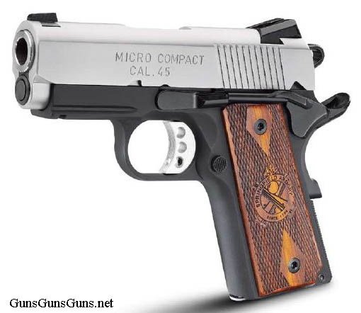

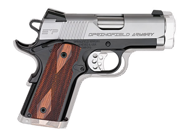

I recently had a customer email asking if I could remake a holster for his Colt Defender 3" 1911. I made the holster around my 3" Springfield Armory Micro Compact 1911. Upon close examination of photos via Google searches, it seems the Colt Defender has a 3" bushing-less bull barrel, while the Springer has a 3" barrel WITH a bushing. The end of the slide seems to be flush with the end of the barrel on the Colt, while the bushing is exposed on the Springer indicating that the Springer has a slightly shorter slide. Can anyone confirm this? I curled the end of the holster inward at the muzzle, and it looks like the Colt isn't seating all the way leaving too much trigger exposed.

The EMP line is bushingless and uses a bull barrel to lock up. You could be seeing the bbl protrude slightly more proud of the end of the slide on the Springer, but it's definitely not a bushing.
You're right - the Micro Compact .45 has no barrel bushing and I'm in fact seeing the tip of the barrel protruding more on the Springfield than on the Colt with it's flush barrel. It's amazing how difficult it is to find photos of the muzzle of a Springer Micro Compact 3" .45 1911.

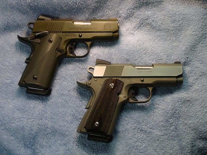

The EMP size is a little different when compared to a standard 3" .45 1911. I've posted a size comparison overlay I found somewhere, but can't find it right now to repost. I did find a muzzle shot of a railed version of the Springer 3" .45, but was trying to find an exact comparison (non-railed Springer vs. non-railed Colt - both .45's, both 3") to get a better idea of why the Colt Defender isn't fitting in my Springfield Loaded 3" Micro Compact .45 holster.
Ahh, found it -attached.

Im sorry Particle, it was late last night when i wrote the post....the Defender is the longer of the two...i was just looking at the two side by side a few minutes ago and i THINK the dust covers are the same, its just the barrel on the Defender is a little longer. Im not home right now, im on here through my phone, but Ill try and post a few pics tonight or tomorow of the two side by side for ya. On another note if anybody is wondering, the Para Ordnance line of 3" bushingless barreled 1911's are the same size and the Springers as far as the barrel length goes....ask me how i know...lol. I traded the Para off for the defender and now i have a drawer full of unusable holsters thumbsdown.gif
