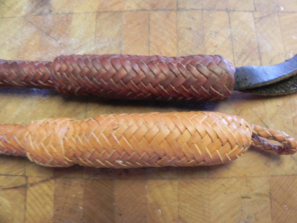

Members Melanie Wilfong Posted April 25, 2011 Author Members Report Posted April 25, 2011 Thank you Tracy. I have had a problem w/twisting. I read the tutorial several times and I am confused on a point Alan makes about going back up on the braid. With 2/3 of the length of my strings to my left I start the braid by going under one over one. and I continue with each string in succession moving from top to bottom Once I have all of my strings done i set it into my vice to hold it while I braid Once I reach my goal I start the turn back. I finish my braid with an over so I can start my braid with an under. This is with the strings that are still going the left. I'll come to a place where the strand will need to work itself back into what has already been braided. Then I go parallel to the string on the left I do this with each string in succession first working 4 of them to the left and then i go back and work them in succession to the right of where I started. This helps me from putting a twist into the finished noseband. Here I am half way back up creating pairs. . At this point I started getting late so I wrapped the noseband in a moist cloth and let it set on my bench to preserve the moisture content. To be continued... Vaya Con Dios, Alan Bell Bob Marley - Ride Natty, Ride Can someone explain this? " I do this with each string in succession first working 4 of them to the left and then i go back and work them in succession to the right of where I started. This helps me from putting a twist into the finished noseband. Here I am half way back up creating pairs." The strings to the left split pairs. I an confused what he means by the 4 strings on the right, then work to the right. I've been working w/ the first string on the left, then continuing to the left until all are going up creating pairs. Thanks Quote

Members Alan Bell Posted April 28, 2011 Members Report Posted April 28, 2011 Don't know if I'm to late to be of any help but the twist actually happens as you start the turn back no matter the method, spiraling or braiding down. You have to be careful that as you pull each strand through making pairs ( in the braiding method) or making the first pass inthe spiral method, that you don't pull a twist into your foundation. And nondisrespectmtommy friend Bryan but the easiest way to braid a noseband is the way that works FOR YOU!' Vaya con Dios, Alan Quote
Members Melanie Wilfong Posted April 29, 2011 Author Members Report Posted April 29, 2011 Thank you all, and especially Alan for the awesome tutorial and for the tip on making pairs. I braided it down as Alan showed. Quote
