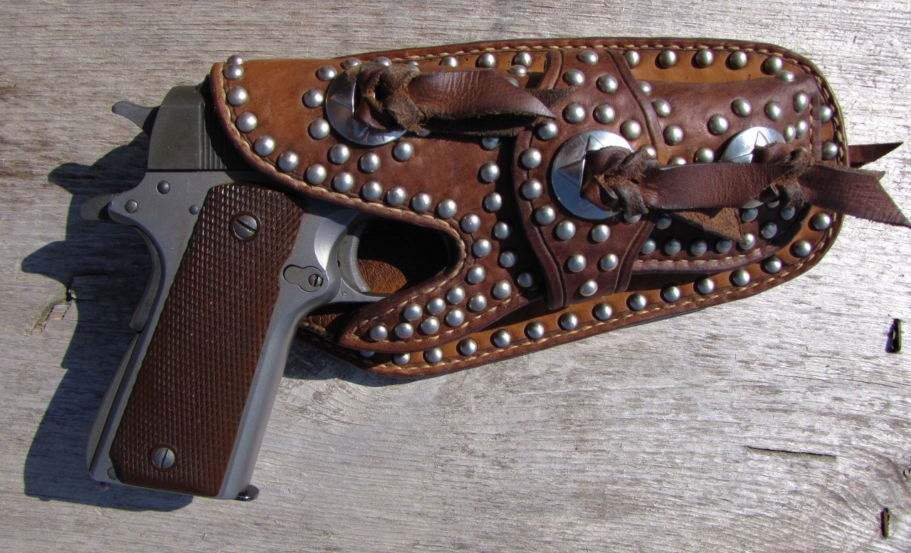

Members DaltonMasterson Posted May 17, 2011 Members Report Posted May 17, 2011 (edited) To keep the post on subject: If you frequent gun shows, you can find a used military 1911 holster for 30 bucks or so. I have one made in 1918, but its missing the flap, so it became a pattern. I have another good one from '44 that was dyed black in the 50s. I used it for the flap portion of my pattern. I think the hardest part will be the wooden block inside the holster, as well as the wire hanger. AND to derail the post again: The Wildbunch rigs are cool, and are getting very popular. Many folks are wanting a military version to go with their outfits, but the western style is popular too. The easiest one is the one in the Stohlman How to Make HOlsters book. Build it as is, and maybe cover the trigger guard if your range requires it. Here is my latest Wild Bunch rig. It is antiqued, but will end up more so when I start using it. Edited May 17, 2011 by DaltonMasterson Quote

Members Rayban Posted May 18, 2011 Members Report Posted May 18, 2011 Here is my latest Wild Bunch rig. It is antiqued, but will end up more so when I start using it. Hey I saw it in the Packing Iron book!! Congratulations!! Quote
