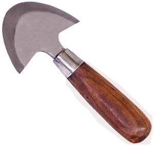

Members Tannin Posted July 26, 2014 Members Report Posted July 26, 2014 (edited) Interesting thread. I'm in a similar position to the original poster. My current thinking is to get a head knife about 4-4.5" - influenced by Al Stohlman's tool book. I currently live in the UK, so would likely buy a new Joseph Dixon knife (they are still making/selling a full range of them ) or something similar by another English maker (e.g. Barnsley). However, if Amazon.com would let me*, I would order the super-cheap "Abetta Round Knife - 6 X 4 1/2" from the USA - just to learn with; I have quite a lot of experience sharpening tools now and am willing to put in the time to create & maintain a good edge. *By agreement with the UK government Amazon & eBay block the sale of most knives, apparently including head/round knives, to the UK. Although they allow the sale of other leather knives if they are labelled as "tools" rather than "knives" and they allow draw-knives - which are correclty recognised as a non-weapon knife/tool, as head/round knives should be IMHO). Seems unfair, as other vendors are allowed to sell them. Interesting to read the recommendation to use a convex edge (as typically used on axes & bush knives for robust edges). For flat ground ("Scandi-grind") edges, I wonder if a little oil (or glycerine or water) on the leather and/or blade might help? BTW Has anyone made a laminated steel round/head knife (e.g. hard middle layer for the cutting edge with softer sides for robustness & easy sharpening e.g. rockwell 58/61/58), like some Scandinavian knives? Edited July 26, 2014 by Tannin Quote

Members KWosnig Posted March 9, 2015 Members Report Posted March 9, 2015 (edited) Difference between a head knife and a round knife is this. A head knife is beveled and sharpened on one side only, flat edge on opposite side for giving square cuts. Round knife is beveled and sharpened on both sides, giving a V cut. Other than that, maintaining the edge is the only requirement, also these knives are meant to be pushed away from you, not pulled towards you or have the blade pointed into your body. Edited March 9, 2015 by KWosnig Quote
