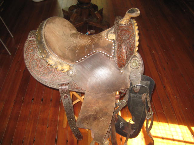

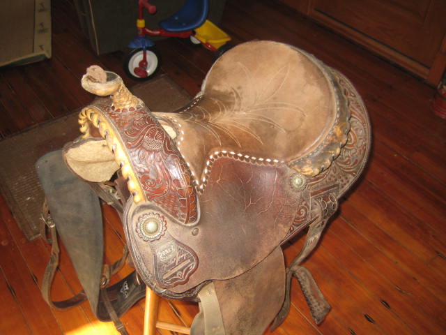

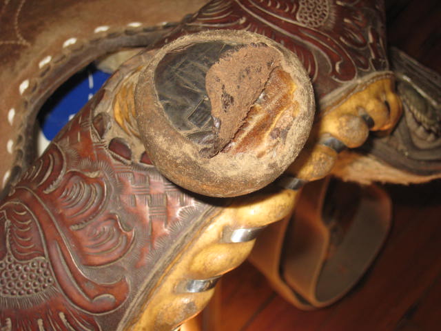

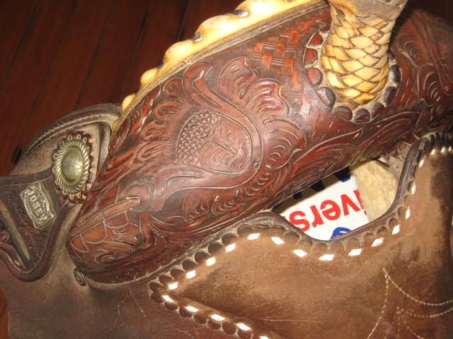

Here is a saddle I'm cleaning for my daughter right now. I bought it off of ebay and I don't think it was ever cleaned. It's a old Martha Josey made by longhorn. I'm just using lexol liquid glycerin and lexol leather conditioner. I first scrub the saddle down with the glycerin and a toothbrush. I then go over it with a damp rag to get excess glycerin off. I then wipe it down with the conditioner. I'm not sure if this is the right way or not but it seems to work for me. I'd also be interested if there is a better way or product. But I have a feeling that if you ask ten guys you get ten different answers.
Mike
post-4953-070901100 1312400821_thumb.jpgpost-4953-000399600 1312400834_thumb.jpgpost-4953-022593700 1312400850_thumb.jpgpost-4953-038146800 1312400860_thumb.jpgpost-4953-037087700 1312400875_thumb.jpg
post-4953-037087700 1312400875_thumb.jpgpost-4953-046011100 1312400890_thumb.jpgpost-4953-046368300 1312400902_thumb.jpg
