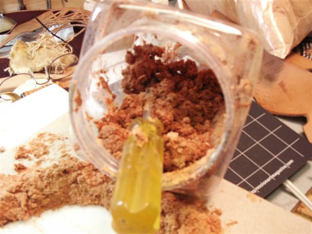

Anne is right, I use a lot of it. Mixed with rubber cement to a consistency of peanut butter or bread dough, it works really good to fill in the cavity created when you do embossed carvings in the style of Robb Barr or Jan Schoonover. Bob Beard uses it to raise the scroll areas on some of his really neat floral carvings. There are some demo's here on the forum that I have done the explain the process. I also use the putty to create bark texture on trees, another thing I learned from Jan Schoonover.
Here are some photos of how I used it to create a bark effect. The first picture shows the putty mixed up in a plastic container. You have to be careful what you mix it in because rubber cement eats some things, like cheap plastic cups.

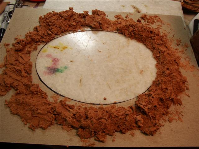

In this picture, I am starting to spread the putty mixture out on a piece of cardboard.
I want it to look something like a hole in a hollow log, so I pinched it up to form a ridge around the hole. The rest of the putty is spread fairly heavy, maybe 3/8ths of an inch thick. You want to be able to create ridges to simulate bark.

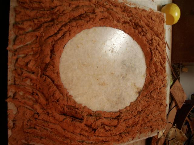

The putty is now spread out, ready to create the ridges
Now take some kind of tool and draw/scratch in the ridges to make it look like bark. I used a screw driver but you could use a modeling tool, a tooth pick, or whatever works.
Here you can see the bark beginning to take shape. It can be rough or smooth depending on the look you are going for
As it starts to dry, it may shrink and leave gaps, or you might have scratched too deep and taken away all the bark. No big deal, just smear some more putty over these areas. You might want to add more rubber cement to the mixture at this point to make it thinner.
Keep working the putty until you get it to look like you want it too. Bark is all different so there really isn't a specific way it has to look.

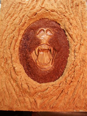

This is how my bark turned out.

I forced him in there at gun point! I know, I know already, bears aren't supposed to be inside trees and buffalo aren't supposed to have feathers. I took the bear back out of the tree, and he is just sitting around waiting for a better idea for a matt. But I like my buffalo with feathers, so I aint changing that one. ;)
