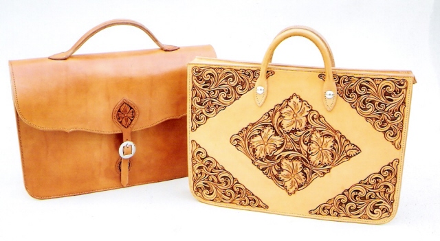

TroyWest Report post Posted June 14, 2008 The one on the left has been oiled, the one on the right, no oil, mahogany antique on both. Quote Share this post Link to post Share on other sites
