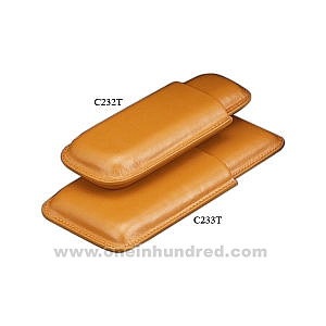

mlapaglia Posted October 26, 2011 Report Posted October 26, 2011 I am looking for a Tan die/stain. One that is tan and not brown with a red cast Feibings dye British Tan and Tan. Not Brown with a Yellow tine, Eco-flo dye Range Tan. Not a brown that would be a nice tan if it was lighter, Eco-flo professional stain Tan. I have not tried Saddle Tan but it looks too dark to me. I can get an acceptable tan color with a single pass of a sponge filled with Range tan but have to watch the edges of the pass as they get too dark if you go over them twice. I took Feibings Tan and cut it 1:1 with alcohol and it wasnt too bad but had a slight yellow look to it. I was able to fix most of the yellow issue with a rubbing the leather down with a sponge and denatured alcohol but it was a lot of work. Should I give up until I get an air brush? Is there a way to get a simple tan color by hand? The picture is an example of what I am looking for. Id even settle for a little darker if there was no red tint. I hope this is a problem with my learning and a lack of understanding. Id hate to find out it cant be done without an airbrush. Thanks for any suggestions. Michael Quote The key to immortality is first living a life worth remembering. Bruce Lee

Scary Leatherworks Posted October 28, 2011 Report Posted October 28, 2011 I agree with Busted. I think your example looks like an oiled piece of vegtan. I do have Fiebings "buckskin" I got from springfield leather that is a light tan color. Quote
Members RidersChoiceSaddleCo Posted October 28, 2011 Members Report Posted October 28, 2011 We get that color with our golden tanned saddle skirting by laying it out in the hot sun for 4-8 hours. Of course now in the winter you may need to use the tanning bed like I have done several times. Just watch out for the wife's right hook! Quote Rider's Choice Saddle Co. 29950 Hwy 71 Bryant, AL. 35958 256-597-2424 Email me Click Here to See Examples!
mlapaglia Posted October 29, 2011 Author Report Posted October 29, 2011 Thanks everyone. I tried some lightly oiled Veg-tan and it was pretty close. With a little sun it should work. The other thing that seems to work is the Briar Brown Stain from Eco-Flo. But on some leather it gets splotchy. Ill have to try the buckskin one. Thanks Michael Quote The key to immortality is first living a life worth remembering. Bruce Lee

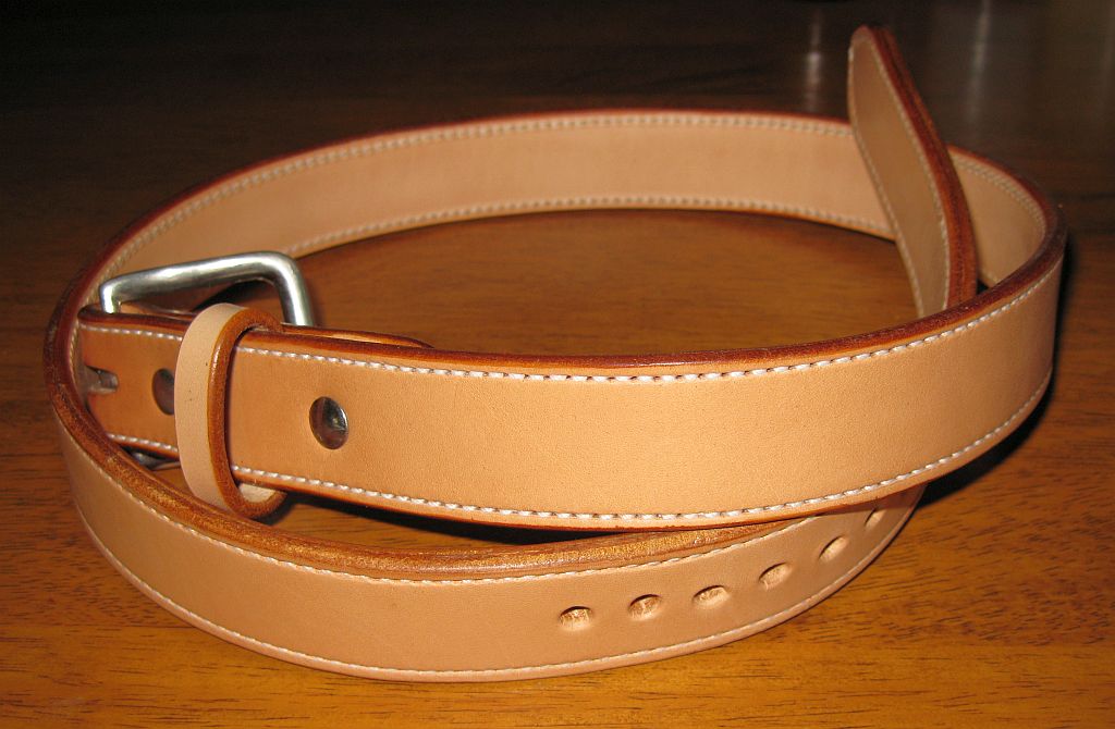

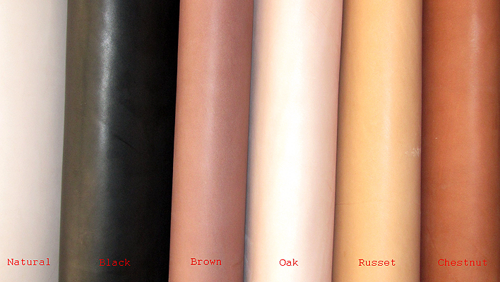

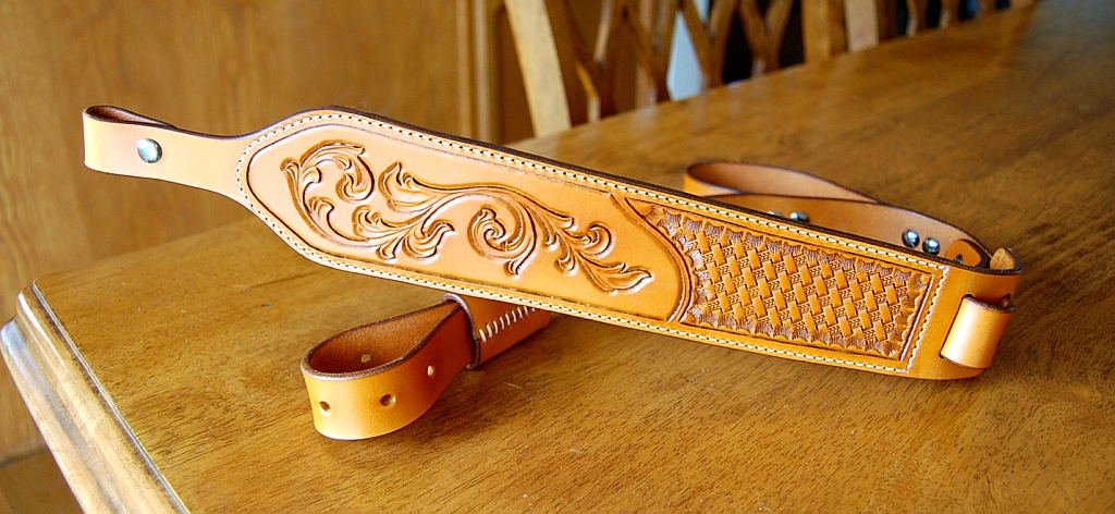

Members particle Posted November 17, 2011 Members Report Posted November 17, 2011 (edited) I agree with the others that said it's just a natural piece of Veg Tan leather. Note that you'll get slightly different results, depending on the brand of leather you're using. This is Herman Oak with neetsfoot oil and clear finish. This is Wickett & Craig with neetsoot and a clear finish. Herman Oak has a warmer tint straight from the tannery, so it will get you that color you're after. Wickett & Craig will need additional work to get that color, like the sun tan, etc. Also, Wickett & Craig sells a pre-dyed "Russet" skirting leather. It looks very close to what you're after IMHO. Edited November 17, 2011 by particle Quote Eric Adamswww.adamsleatherworks.com | Facebook | YouTube | Instagram
mlapaglia Posted November 17, 2011 Author Report Posted November 17, 2011 It is trial and error, but it is also the easiest way to get a good "light" tan or brown, depending. Leave the hide you are going to use in the sun, short periods of time intervals, put a sealer on it when it get the color you want it. The UV will darken it to a color I have not yet found in any bottles. Thanks Ill give that a try when the sun comes back to Denver. I agree with the others that said it's just a natural piece of Veg Tan leather. Note that you'll get slightly different results, depending on the brand of leather you're using. This is Herman Oak with neetsfoot oil and clear finish. This is Wickett & Craig with neetsoot and a clear finish. Herman Oak has a warmer tint straight from the tannery, so it will get you that color you're after. Wickett & Craig will need additional work to get that color, like the sun tan, etc. Also, Wickett & Craig sells a pre-dyed "Russet" skirting leather. It looks very close to what you're after IMHO. I have H&O right now. I have to say that the natural color of Wickett & Craig is way too white for me but the russet looks pretty good. I need to get some neets foot oil. I have olive oil and Lexol but no neets foot yet. Thanks for the pictures Michael Quote The key to immortality is first living a life worth remembering. Bruce Lee
