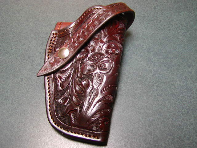

Members katsass Posted November 14, 2011 Members Report Posted November 14, 2011 Again FWIW; The 'Threeprson's' style holster was originally designed for a Smith and Wesson DA revolver, if I'm not mistaken. Personally I feel that this holster, the basis for numerous models of duty holsters for LEO use, as well as many field holsters, is most likely the fastest revolver holster made, as well as a very secure rig. Here is one I made earlier this year for auction by the local 'Friends of the NRA' ----- somewhat embellished. Mike Quote

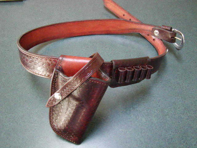

Members Larry Posted November 19, 2011 Members Report Posted November 19, 2011 Hi William, I did a lot of research about Tom Threepersons and found he was quite an individual. I found a picture of his holster and tried to make mine as close to it as possible. I made my Threeepersons holster after about ten or twelve practice projects so I could get the carving as good as I could. I made it for my S&W M66. I have been doing leather work about two years now and I love it. I made a drawing of the carving on his holster and have it in .jpg format. If you like it and want it, I will e-mail it to you. If you follow all the information the guys and gals here have given you, you will do find. Read the book and plan your holster. Remember, it's just leather and if it doesn't satisfy you, do it again. You'll have fun and you'll have a holster you can wear with pride. Much better than buying one. I also made a six round cartridge holder to fit on the belt next to the holster. Quote
