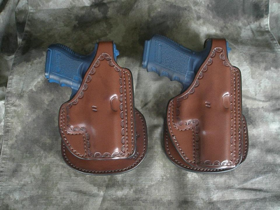

Members Shooter McGavin Posted November 23, 2011 Members Report Posted November 23, 2011 I really dislike using, making, and generally looking at, paddle holsters. However I have a friend who prefers them over all other options. So I started out with a spare Galco paddle and ended up with this. He was very happy with it. Drum dyed W&C 7-8oz saddle skirting, ostrich leg from Springfield. Attached to the paddle using #6 tee-nuts (sandwiched between the neg-tan backed ostrich leg and the main body) that engage into the holes in the Galco paddle and secured with some stainless #6 pan head screws and flat washers. Quote Zlogonje Gunleathers

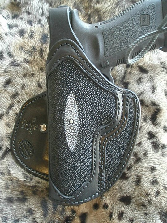

Members troop Posted November 24, 2011 Members Report Posted November 24, 2011 all of my paddle holsters are leather with kydex strip inside for rigidity. way more comfortable than the plastic paddles. using only a 1 1/4 kydex strip in the middle also allows the leather on the sides to conform to the body.can't find the back and side view pictures. but the flesh side sits against the body on these. Tony Quote The hand that feeds you also puts the chains around your neck.
RMB Custom Leather Posted November 24, 2011 Report Posted November 24, 2011 I really dislike using, making, and generally looking at, paddle holsters. However I have a friend who prefers them over all other options. So I started out with a spare Galco paddle and ended up with this. He was very happy with it. Drum dyed W&C 7-8oz saddle skirting, ostrich leg from Springfield. Attached to the paddle using #6 tee-nuts (sandwiched between the neg-tan backed ostrich leg and the main body) that engage into the holes in the Galco paddle and secured with some stainless #6 pan head screws and flat washers. Nice work! What paddle did you use? I have some uncle mike's but like yors better. Post apic of the back side. Quote Thank you, Rob Bennett Email: rob@rmbcl.com Authorized Distributor BLUEGUNS Multi Molds Maker Supplies Home of the "Taco Press" kydex/Leather former FREE SHIPPING! FACEBOOK
