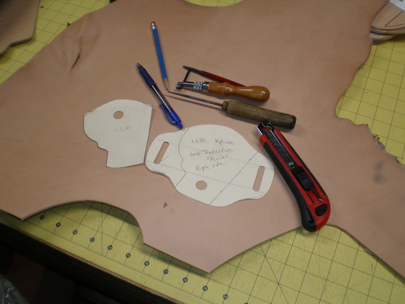

Members Haystacker Posted December 2, 2011 Members Report Posted December 2, 2011 Markush, What a great job. If you want to tighten this holster, just add another stitch line. Before you make your next holster, make another copy of your pattern. Then trace in the stitch line a little tighter, using your holster as a guide. Then cut out the stitch line pattern and use this when you make you next holster. all of my patterns are two pieces. The outside and then the inside stitch lines. I hope the pictures help explain what i mean. Again, looks great. best regards, Jeff Quote haysholsters@hotmail.com NRA Life Member
