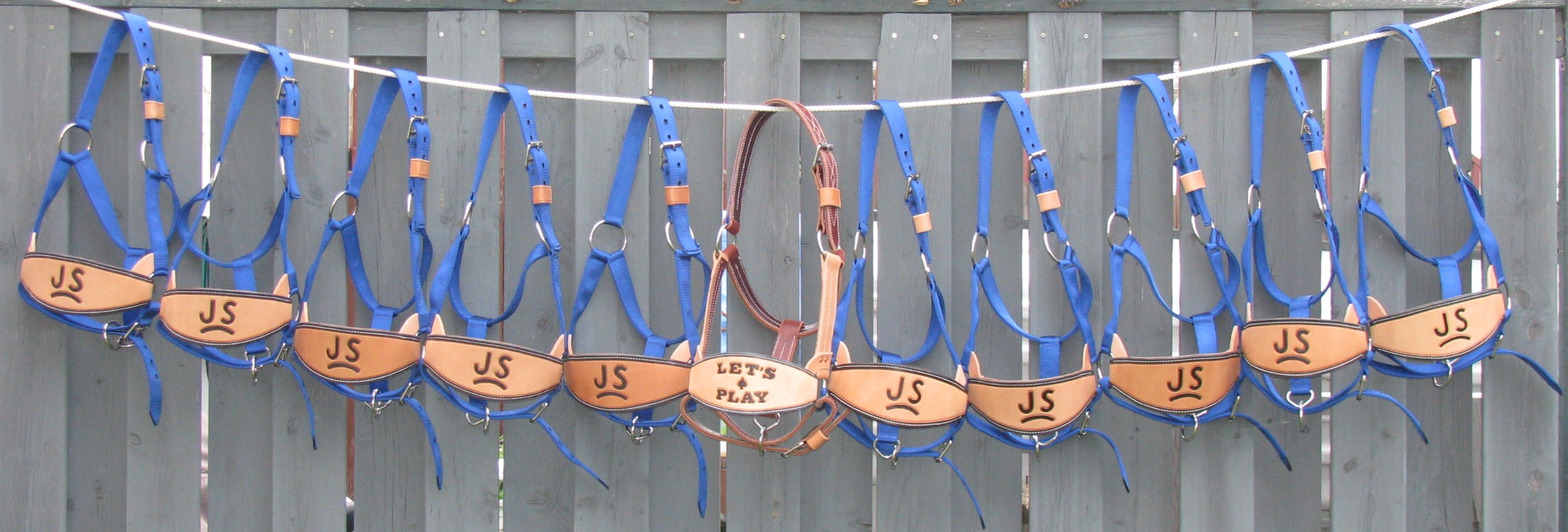

Elton Joorisity Posted June 26, 2008 Report Posted June 26, 2008 (edited) Here's a bronc halter order that I did for a stock contractor friend of mine from Montana. The "Let's Play" halter will be adorning the Montana Circuit Finals Bareback Horse of the year who is coincidentally named Let's Play. He requests nylon goods all of the time because it's easier for him to take them to the carwash to pressure wash them clean if they get muddy. Edited June 26, 2008 by Elton Joorisity Quote
Elton Joorisity Posted June 26, 2008 Author Report Posted June 26, 2008 See why I go through so many of Weaver's 999WL buckles now Bob? I've orderred a lot more of them since we got that first batch. Quote
Moderator bruce johnson Posted June 26, 2008 Moderator Report Posted June 26, 2008 Elton, Good looking headgear. Thanks for the look at the hardware too. I have been using the SS #999, but looks like the WL 999 might be a little handier to buckle with the loop for the strap holding it on. I have been using the #3620 dee and ring. The Weaver catalog lists the 1-1/2" in #3610 as a new size, so they might not have been around when I placed my "enough for a lifetime" order. It's getting less though, I think I have 6 of them left. On another note, I got an email last night from a guy. Any sources of latch buckles for flanks? Quote
Elton Joorisity Posted June 26, 2008 Author Report Posted June 26, 2008 The #999WL buckles will be my standard for bronc halters and flanks from now on. Saves a lot of time by not having to punch slots for the tongues. I just wish they made the 1 3/4" in stainless. Maybe if we all beg for them it will happen. As well I really like the #3610 loop and ring. I always used to use a ring and a carriage bolt on the throat to chin connector and HATED the looks of it!!!!!!!!!!!! Quote
Moderator bruce johnson Posted June 26, 2008 Moderator Report Posted June 26, 2008 Elton, I'll kick on Weavers too for a 1-3/4" WL 999. My standard is 1-3/4", which is I guess why I bought a pile of the 3620 dee and rings. Under the chin 1-1/2" ought to work. They are made from pretty heavy duty stock too. Agreed on the bolt and ring undet the chin too. They work OK, but just look they were an afterthought. Do you ever get any requests to reverse the halter, put the buckle on the off side? Quote
Elton Joorisity Posted June 26, 2008 Author Report Posted June 26, 2008 I honestly thought about doing half these halters for left hand delivery and the other half for right hand delivery but then I thought that it would just lead to a bunch of confused bronc riders!!! I have had requests for a buckle on both sides in the past too. Another thing I'll mention is that John already had a set of halters from a year ago from another maker. They were made for USA type broncs and didn't fit Canadian bred feather footed swell rippin snake stompers very well!!!!!!!!!! These halters are made to fit "Swamp Donkeys" as John puts it. Quote

Members Hidemechanic Posted November 2, 2008 Members Report Posted November 2, 2008 Elton, You've you've been crankin out some awful nice stuff this year. I'm glad you've been keepin busy. Here's a shot one I made back when that kind of work was still around here. Always good to see your stuff. GH Quote
Elton Joorisity Posted November 2, 2008 Author Report Posted November 2, 2008 Hidemechanic, did you use "t" nuts on the backside of the nosebands for the screws to thread into?? Quote
Members Hidemechanic Posted November 2, 2008 Members Report Posted November 2, 2008 EJ, To tell the truth I forget where those came from but they are like monster Chicago screws. Courser thread and harder steel. It was smooth enough on the back after I cinched it down that chafing was no prob. GH Quote
ArtS Posted November 2, 2008 Report Posted November 2, 2008 They look great Elton. Can you post a picture of the inside of the nose band please. Thanks, Art Quote
Elton Joorisity Posted November 3, 2008 Author Report Posted November 3, 2008 Art, Thankyou. I'm sorry but I shipped those halters about 3 months ago. The inside of the nosebands are pretty boring. Simple latigo lining. Quote
