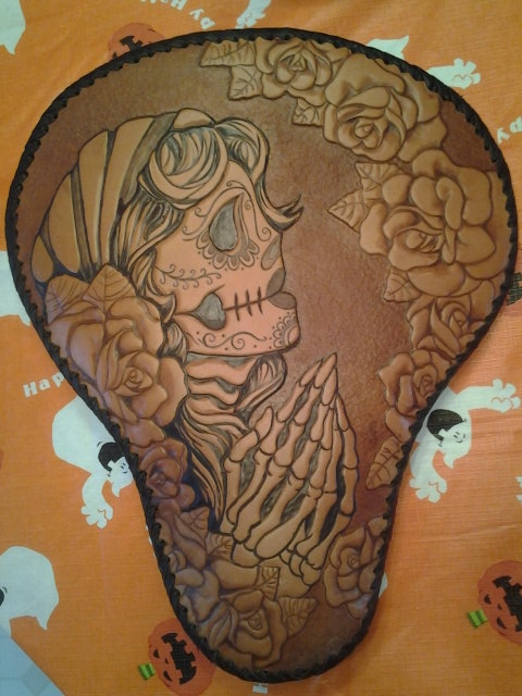

Members Miloradovich Posted October 15, 2012 Author Members Report Posted October 15, 2012 I had some things come up that required me to take some time off from this seat but I finally got back to and it and got it laced and dyed recently. Feels good to be almost done. My friend that I am making it for will be happy to get it on his bike after all this time. Quote
Members Horrrk Posted October 16, 2012 Members Report Posted October 16, 2012 Hi Milo.. I've just been reading through this whole thread, the pictures, links and the advice given as well.. It's been an inspiration to hear from the guys who are making seats, about their dyeing techniques and finishing advice too.. Chancey and Cyberthrasher..your advice has helped a lot of other folk out there too, I'm sure.. I know I have this thread saved as a watched one, so cheers.!! The seat has turned out fantastic.. I think the design is beautiful and the colours that you've gone with make it stand out, without shoving it in the viewer's face.. Subtle, is what I'm trying to say, I guess..lol Absolutely love it.. I hope your friend does too Regards Phil Quote
Members Miloradovich Posted October 16, 2012 Author Members Report Posted October 16, 2012 Thank you very much. I am pleased with my results, especially considering this is my second attempt tooling. I definately would not have gotten the end result that I did without all the great advice and tips I recieved on this forum. It was a huge help! I did a little bit of touch up dyeing and darkening to the flowers and background last night and will hopefully get the touchups i need on the black done tonight after the kids go to bed. I put this away for so long it is great to be this close to finished. Just in time for it to go on the bike for winter....lol. Quote
Members Horrrk Posted October 16, 2012 Members Report Posted October 16, 2012 Thank you very much. I am pleased with my results, especially considering this is my second attempt tooling. I definately would not have gotten the end result that I did without all the great advice and tips I recieved on this forum. It was a huge help! I did a little bit of touch up dyeing and darkening to the flowers and background last night and will hopefully get the touchups i need on the black done tonight after the kids go to bed. I put this away for so long it is great to be this close to finished. Just in time for it to go on the bike for winter....lol. Well..great work for only your second go at tooling.. I know what you mean about the help and advice on here..it's astounding how friendly folk are, how they are pleased when you succeed and lets face it, so near to the end of the project, these few people know exactly what sweat and tears have gone into this.. As far as your friend goes, Im sure as you say, he'll be pleased to get hold of it finally.. After all, anyone would be proud to have a seat like that to look at, drool over and polish for a few months..lol Regards Phil Quote
Members shtoink Posted October 17, 2012 Members Report Posted October 17, 2012 (edited) Clearly you taking the time to plan out your next step after completing the previous one has paid off. The results are very stunning. I was in the middle of admiring it when my wife walked by and commented that I needed to make my work look more like that. Clearly, I have something new to strive for. Thank you very much for sharing the progress with us! Edited October 17, 2012 by shtoink Quote
Members Cyberthrasher Posted October 17, 2012 Members Report Posted October 17, 2012 Ditto that one. I'm still in awe of the subtle color combinations you got here Milo!! I can't tell you enough how BEAUTIFUL it came out!! And don't feel too bad about it taking so long - I have a seat that I started back in April that's still not done. Since it was for fun it keeps on getting put aside until I clear up customer orders. Suppose it's a good thing that that hasn't been happening Quote
Members Miloradovich Posted October 23, 2012 Author Members Report Posted October 23, 2012 Clearly you taking the time to plan out your next step after completing the previous one has paid off. The results are very stunning. I was in the middle of admiring it when my wife walked by and commented that I needed to make my work look more like that. Clearly, I have something new to strive for. Thank you very much for sharing the progress with us! Thanks for the kind words, thats quite a compliment! I don't know if it was necessarily taking time to plan ahead or just slacking off, haha. I definately struggled through parts of the process but am happy with the end result and happy to be done! I learned a lot, especially with the advice here and expect things will go smoother on anything I try in the future. Ditto that one. I'm still in awe of the subtle color combinations you got here Milo!! I can't tell you enough how BEAUTIFUL it came out!! And don't feel too bad about it taking so long - I have a seat that I started back in April that's still not done. Since it was for fun it keeps on getting put aside until I clear up customer orders. Suppose it's a good thing that that hasn't been happening Thank you! I appriciate you feedback and tips through the process too. I tried to go for a little bit of the halo effect that you metioned early one by darking the edges of my background around the figure and roses with extra coats of the background color. It was looking pretty sharp but unfortunately the entire seat darkened when I sealed it up. I hope it will lighten up some but I don't know for sure. Glad to know I'm not the only one who puts stuff off for a long time. My buddy is happy to see his seat on his bike now for sure but I guess he really can't complain about the extended timeline when it's for free. We took a ride up through the mountains on Sunday and here are a few shots I took of the seat on his bike when we stopped for a break. Quote
Members Cyberthrasher Posted October 23, 2012 Members Report Posted October 23, 2012 DON'T WORRY ABOUT THE COLOR!!!! That is gorgeous and a PERFECT match to the bike. I'm really digging the ride too. Those struts are similar to something I was thinking about at one time Quote
Members Horrrk Posted October 23, 2012 Members Report Posted October 23, 2012 Yeah it has gone darker Milo, but IMHO it goes really well with the bodywork colours.. Totally beautiful..the bike AND the seat.. Well done indeed, on your part.. The bike wouldn't be anywhere near as classy with an off-the-shelf seat, that's for sure.. Thanks for posting the pics..it's good to see it in situ.. Regards Phil Quote
Members Miloradovich Posted October 25, 2012 Author Members Report Posted October 25, 2012 Thanks for the kind words guys! It does go well with the bike and Nick's happy to have it on there. Says it much more comfortable than the temp he's been using the last 10 months. I am liking the darker shades the more I see it mounted, I am kinda thinking the dark color helps make it pop bit from the paint. This w650 was his first build and he's included some nice details to it like the struts while getting it all done on a pretty low budget. The seat was my contribution since I suck at any kind of mechanical work and wasn't much help with that aspect. Quote
