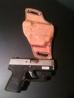

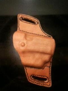

Members leggo ma eggo Posted February 9, 2012 Members Report Posted February 9, 2012 Good Morning- Need some help with a heat box/Dry box. I have been told to just get a convection oven and others have said to make one. I cant find any plans for one on the net. It will be used mostly for holster and small items. Can some one point me in the right direction? thanks I'm new to Leatherworker.net, so, hello.... This will probably make a few of you laugh, but with the few holsters that I have made, I found that setting the holster on top of a lampshade of a lit lamp for several hours after I finish wet molding them does a pretty decent job of drying them out and stiffening up the leather. Funny thing, I also found out that water that is too hot(boiling) will shrink leather instantly and make it as hard as a rawhide chew toy for your dog. I leave the pistol in the holster inside the wet holster for about half or a little more of the time on top of the lampshade then remove it for the final drying. Quote
