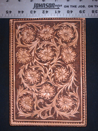

the e-reader sleeves are easy. i just made one for my gf. i hand stitched it and i didn't plan putting anything on the back then decided to so my borders around the outside didn't match up all to well.

here is also the ebook reader i made a few weeks ago.
good luck

your e-reader cover looks amazing! thank you so much for all the info. I will be sewing by hand and eventually would like to learn the different techniques such as stamping, carving, painting, decorative braiding, etc. I've been reading this site for a few weeks and feeling a little overwhelmed with all the info, so I'll just buy whatever I need for each project and then add more tools accordingly. Once again, thank you for your generous advice. This site is awesome!!!
