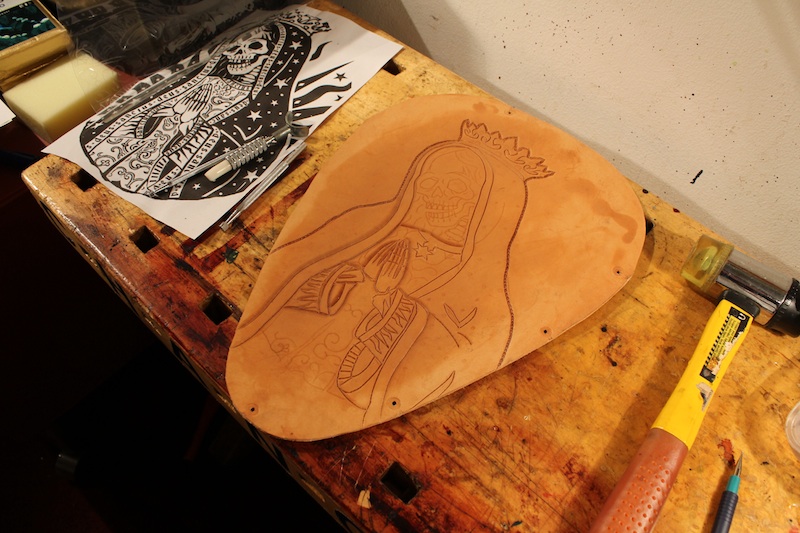

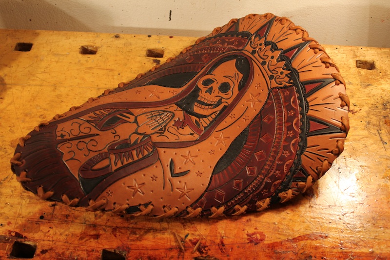

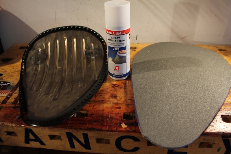

Members chancey77 Posted February 24, 2012 Members Report Posted February 24, 2012 I didn't really want to write a tutorial on this seat...after all a picture says a thousand words:) So here is 3 days to conjure carve and mount this seat for my friend and client on his home built 57 Panhead! He made a lot of the custom metal parts for the bike. Like the Brass Crown gas cap which is amazing! Beginning with my seat pan, and some thin neoprene, because it is a springer it didn't need much padding. All the way through the end of 3 days when we mounted it and he kick started his bike and left my shop:) I know some folks wanted to see some Brush techniques and here is a decent example....there is a few more of my secrets buried in these phots, so if you study them you can get some easy time savers...I tried to show the tools I used during the process...except for ya i din't paint the dye on with a hammer...hahaha Anyway ENJOY! You can't as much as Kaj does but hey, you gotta build your own bike for that! Chancey Quote
