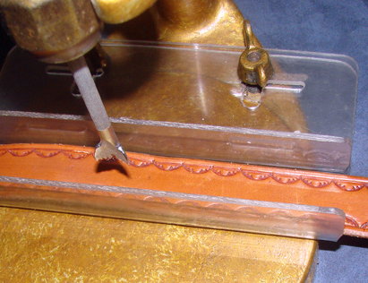

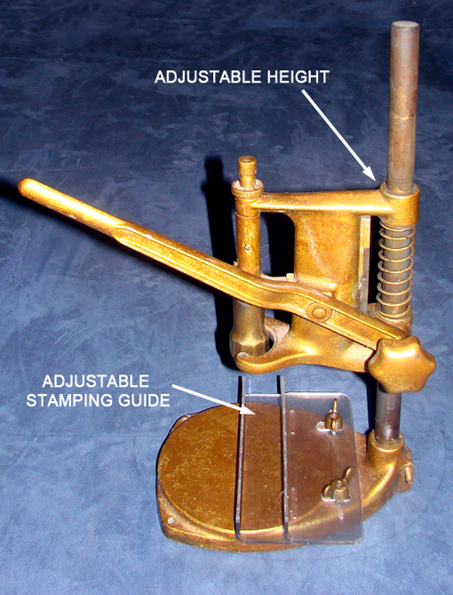

What I don't like about Arbor presses is that the height is not adjustable. I tried using a drill press, but the disadvantage here is that the chuck can rotate, upsetting the alignment for continuous stamping.
Then I had an idea!
I found an old Black and Decker electric drill stand, similar to photo 1
I modified it by, in place of the drill, fitting 3/4" galv pipe threaded at the base to take an old chuck from a hand brace - this will take all diameter stamp handles, yet will not move when tightened on to the stamp (photo 3)
A guide for leather straps etc is made from acrylic and is adjustable via 2 wing nuts (photo2)
The last pic shows closeup of the result using this press. It works beautifully and cost me a total of $7 for the old drill stand and chuck.
Then I had an idea!

The chuck will take tools up to 1/2" diameter, which makes it very versatile - so the answer is YES!
